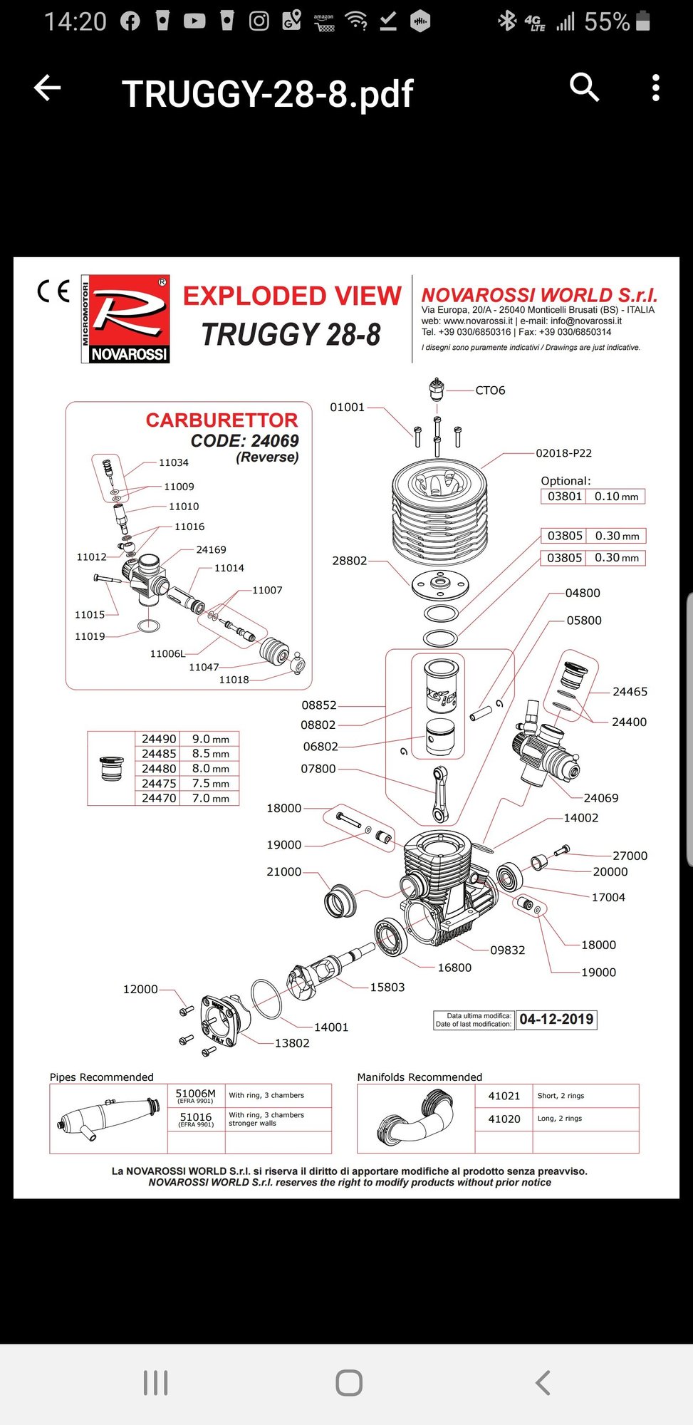

Chad Millikan 12-19-2019 02:25 PM
Originally Posted by rigelkent09 (Post 15563335)
Hi guys, I’m wanting to convert my 28-8 engine roto to bumpstart but don’t know if it’s possible and if there specific backplate for it, if anyone here had done it before please need help here, thanks.
You need a different crank shaft, 15803 (or cut off the extra piece that comes past the rod), and you need the 13802 back plate
https://cimg6.ibsrv.net/gimg/www.rct...2f6ccb97a4.jpg
blankenj99 12-19-2019 03:50 PM
And possibly different (lower) engine mounts...
rigelkent09 12-19-2019 03:56 PM
awesome, thanks for the help, I will buy the backplate and just grind the crank.
Chad Millikan 12-19-2019 06:02 PM
Yup, it's just the last 4mm or so, after it steps down to smaller diameter. And like he said, lower motor mount, so the bump box will hit the flywheel.
rigelkent09 12-21-2019 06:16 AM
awesome, again thank you very much.
