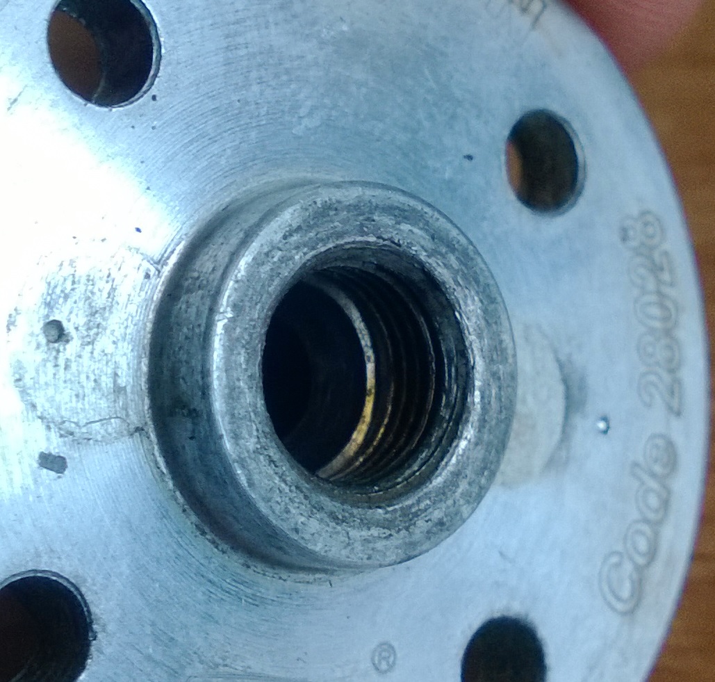

The threads and seal seems OK?
As I was taking off the clutch, noticed both bearings were shot, the front bearing completely fell apart! Could the bearings be the cause of the issue?
I think I'll get a new button just in case.
Attached Thumbnails NOVAROSSI  Engine thread....-button-1.jpg   NOVAROSSI  Engine thread....-seal.jpg   NOVAROSSI  Engine thread....-thread.jpg

THE PHILLY JYNX's Avatar
Joined: Aug 2009
Posts: 1,545
Post up a pic of the piston out of the sleeve. From the looks of all the stuff stuck to the head button your gonna need more than a head button.

Yeah you got some foreign debris up there!

Looks as if you have metal deposites forming and/or a build up of dirt around the plug hole in the combustion chamber.

I think you might want to find a new fuel. Can you get Byrons? I run the balls off my engines and run them at a high temp (my plus 4 anyway) normally around 270 to 280 and even after a solid 8 gallons I never saw rust build up like that, always a golden color and a nice coat of oil. Are you running it out of fuel and letting it sit some place that is not conditioned like a garage or shed?
I dont race that often, maybe one a month. Yes, after race day, I run the fuel tank/engine dry of fuel and put in a few drops of the Nova after run oil and it sits in my shed, gets warm in summer in there!
There is another LHS which stocks Byrons, is this a better fuel then the AT Racing Ive been using?
RCNitro13 is offline

wow that thing needs a major clean out. Rust and Gunk everywhere! There is your problem.
