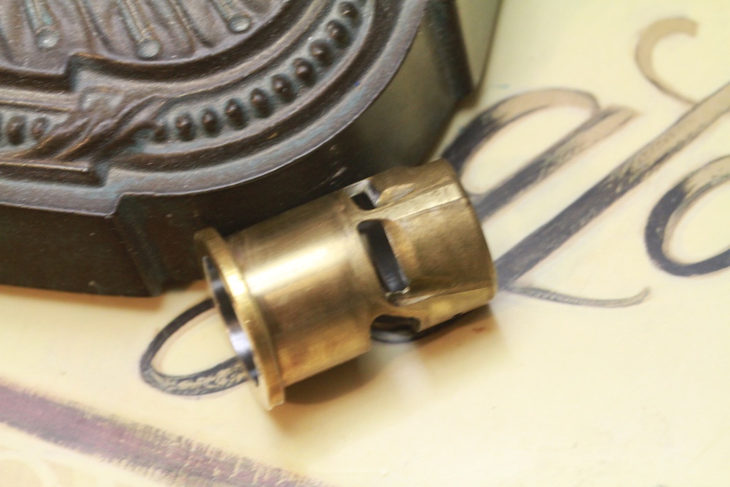

Luckylouse 04-17-2012 07:52 AM
5 Attachment(s)
These are Macro Pics of my Sleeve after about 2 Gal. Please keep in mind that these are macro shot so the little lines are microscopic, just like looking through a high-end magnifying glass. Note that you can see the polishing lines going horizontal on some of the shots. That would give you a reference to the magnification. 4 more pics to come.

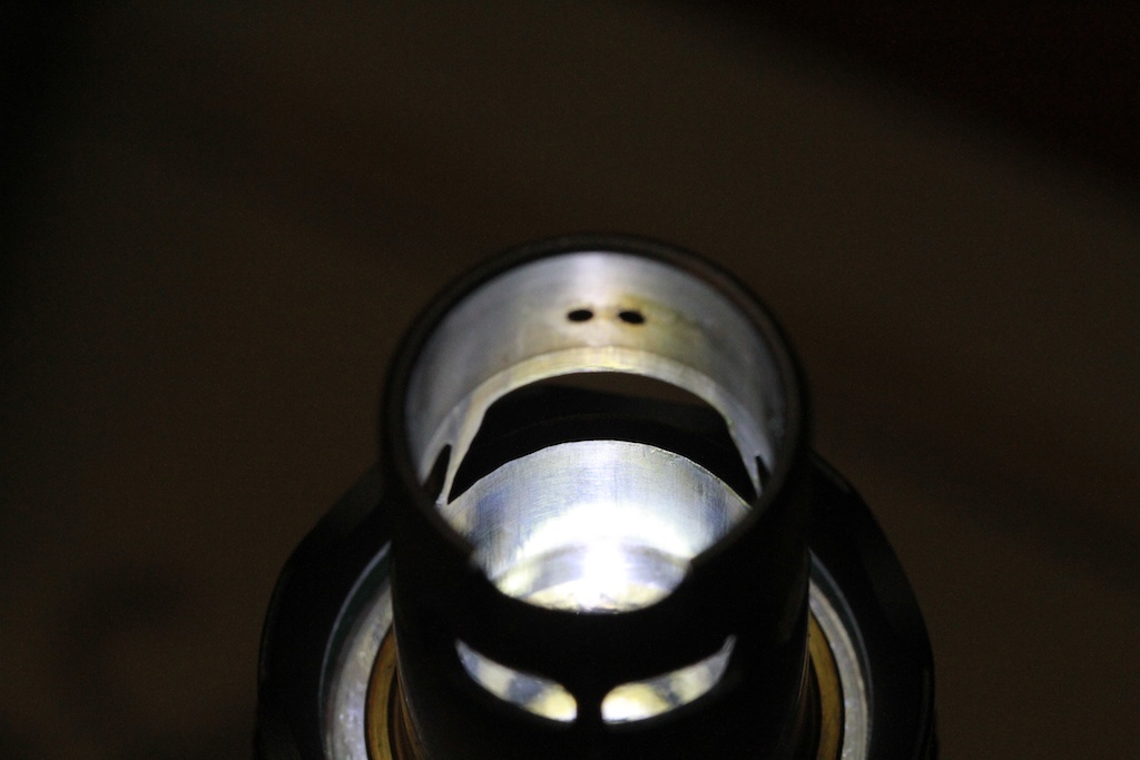

Luckylouse 04-17-2012 07:58 AM
3 Attachment(s)
Attachment 908854
These last 2 are blurry... took the camera off the tripod.
Attachment 908855
Attachment 908856
It would interesting to get these magnified pics from other Modded Sleeves to compare.

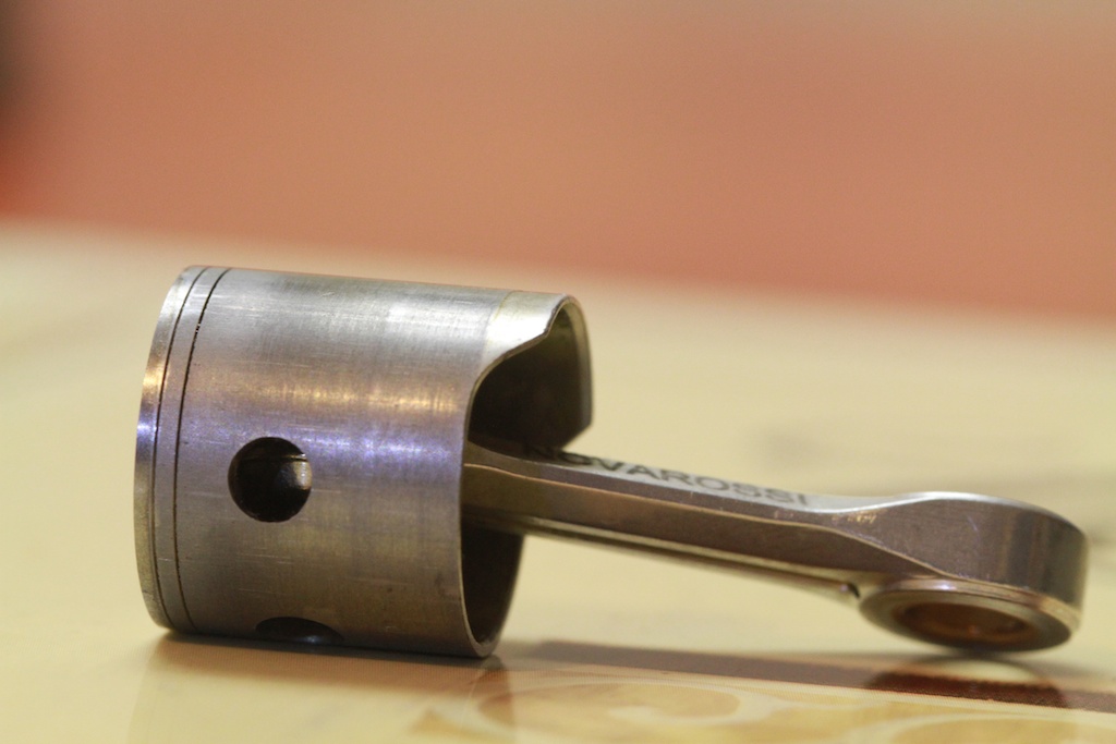

Luckylouse 04-17-2012 08:25 AM
5 Attachment(s)
pics of the Piston.
