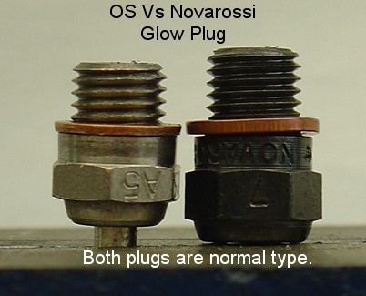

Well here is a photo I just took of a OS plug and Novarossi plug so those who didn't know there is a length difference (like me) can see the difference. Both plugs are "normal", not turbo plugs.
