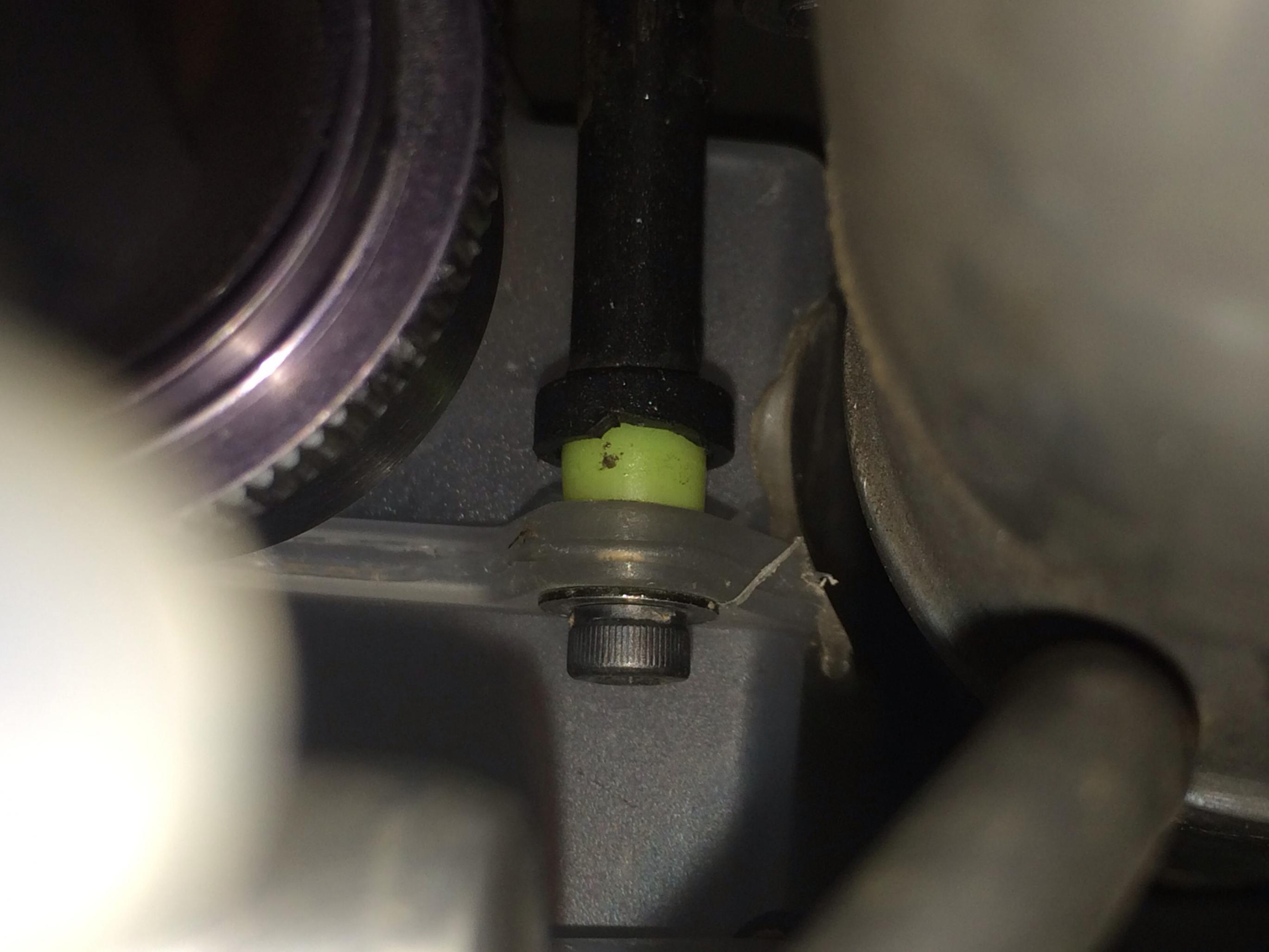

Simple and easy to fix , drill out the hole and install 10mm of fuel tubing which is yellow in my case in picture.
Plenty of cushioning and it does not look silly at all as no one even see it
Any other questions just ask.
Ok just noticed my picture is upside down again DOH. Lol. But you get the point

The tank should not be loose at all. It should be snug and be able to 'rock' on the posts to absorb shock and vibration. But, like any screw on any vehicle, if you over-tighten the tank mount screws, something could break.
We're looking into different things right now. We realize some customers are having trouble with the tank. But with all of the testing and the majority of customers not having issues, we are trying to figure out what is causing repeat breaks in some setups. Is it the way it's being installed? Is it the tank itself? We don't know yet.
It may be that there isn't much room for error while mounting the tank. The screws can't be too tight or too loose. The pipe hanger must not interfere with the tank. The pipe should be placed away from the tank. The tank must not hit the chassis (i.e. do not over-tighten and flatten the o-rings). Like I posted earlier, we might need to add some more info to the tank install page so the tank mounting instructions are more clear.
All that said, we are still pursuing any issues to lessen the chance of a broken or damaged tank.

From: South Dakota
Guys, the first batch of DNX408t truggy tanks had the same tank breakage issues. I used a longer screw and slid some fuel tubing over it. I'd only tighten the screws snug to let the fuel tubing allow the tank to flex with the chassis and absorb hard hits. I also used an extra o-ring under the tank tab insert for cushioning. I did this on the front and back. I never broke a tank when I ran the truck all last year.
TD eventually added more plastic material around the mounting tabs to beef them up a bit.
Something like this could possibly work with the NB48 tank.
