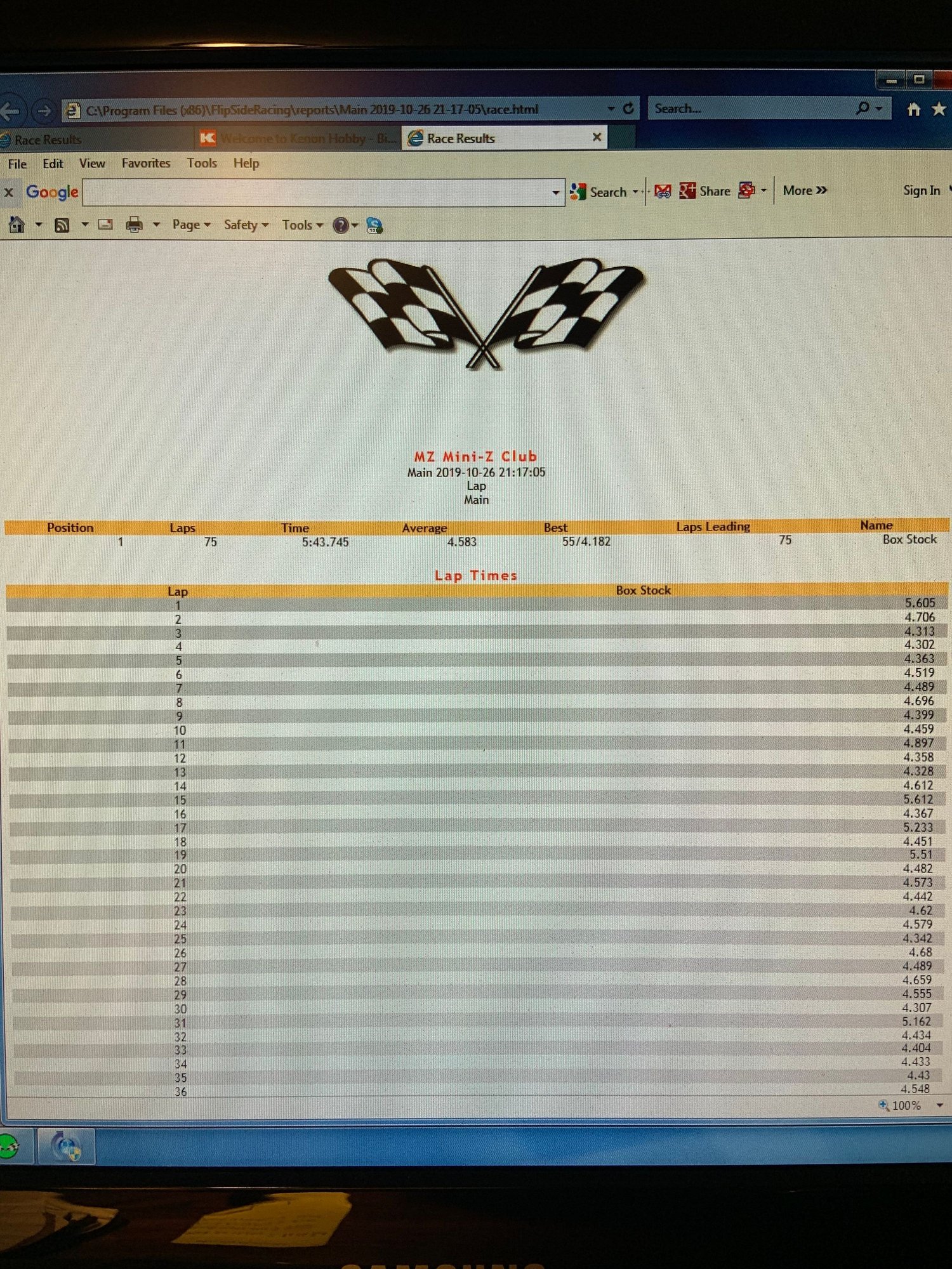

Class-Box Stock
Date-10/26/2019
Location-Winston-Salem, NC
Race Time-5:43.745 (343.745)
Fastest Lap-4.182
Chassis-MR-03 ASF
Body-911 GT1
Wheelbase-90mm
Tires-K30LH fronts, K20R rears
Motor-Stock
Batteries-Kyosho 800s
Front Springs-PN Green (medium)
T-Plate-PN Carbon #4
Motor Mount-Stock RM
Dampener (If applicable)-None
Notes-Had a little time today and decided to see if I could beat my previous Box Stock best run on 10/5, and on the first try I improved my total time by almost 9 seconds. Thankful for a little extra buffer since I wouldn't be able to put up anymore times this month...

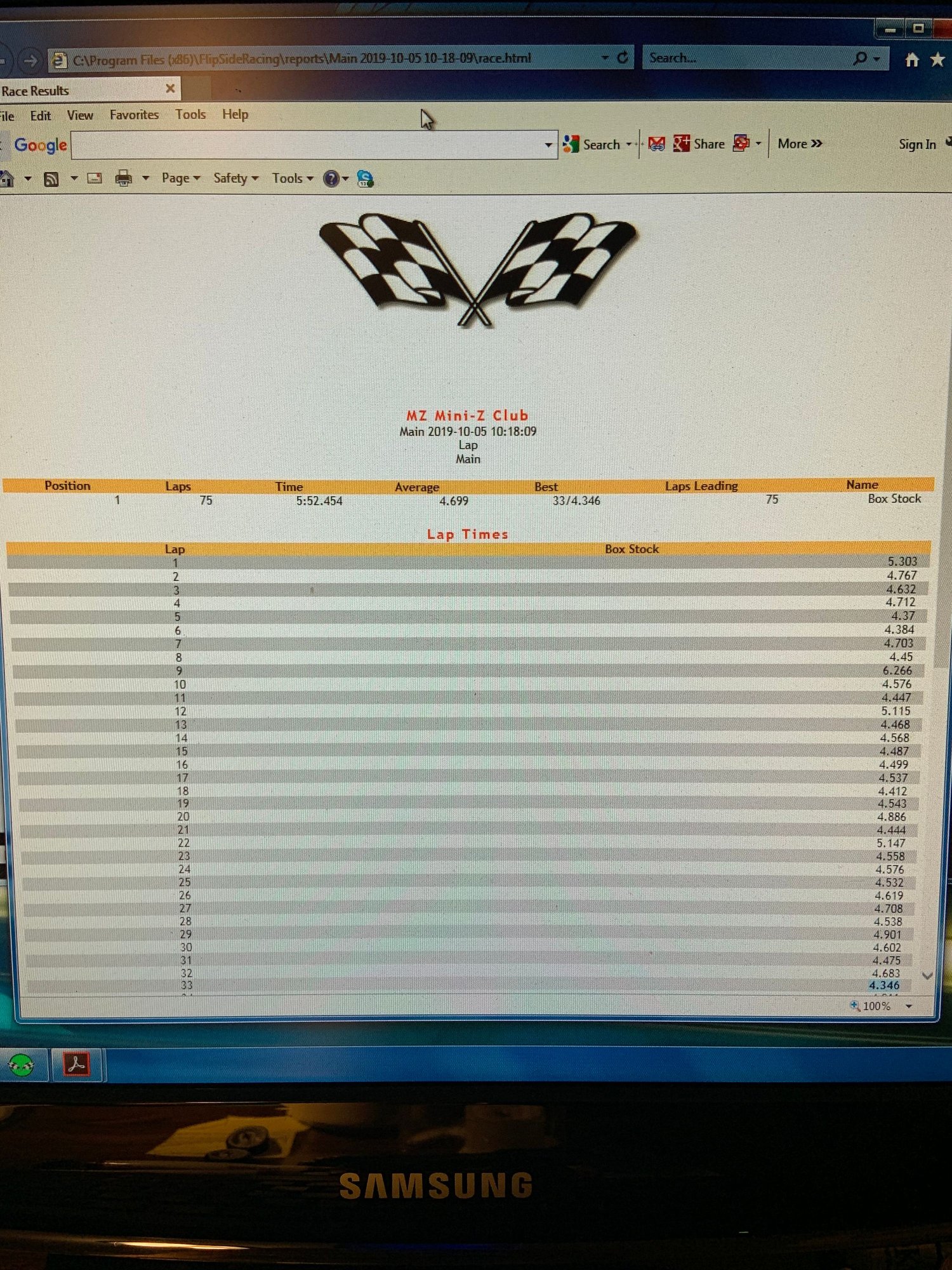

Class-Box Stock
Date-10/5/2019
Race Time-5:52.454 (352.454)
Fastest Lap-4.346
Chassis-MR-03 ASF
Body-911 GT1
Wheelbase-90mm
Motor-Stock
Notes-After a few more CCW runs and going to 30 fronts, I beat my CW best run...

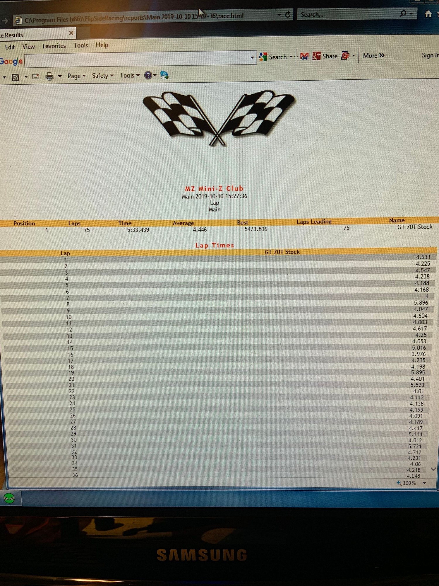

Class-Stock
Date-10/10/2019
Race Time-5:33.439 (333.439)
Fastest Lap-3.836
Chassis-MR-03 ASF
Body-Ferrari F-430 GT
Wheelbase-94mm
Tires-K30 LM fronts, K20 radial rears
Motor-PN 70T
Front Springs-PN Red
T-Plate-PN CF #5
Motor Mount-PN 94-98mm v2
Gearing-PN 64p 10/54 Ball diff
Notes-After several CCW runs with this car and switching to LM front tires, I've shaved off 15 seconds, but still need 5 more seconds to beat my best CW time!

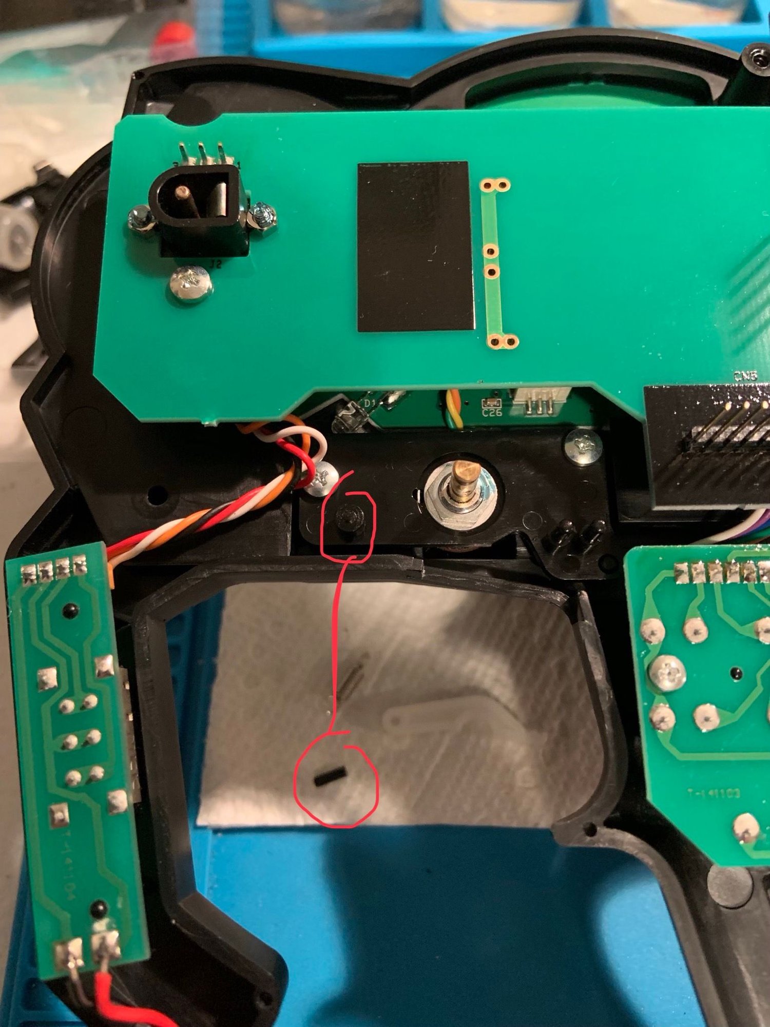

Bad news! Last night while running some laps, I felt/heard a snap and then some components falling and clanking around in my EX-10 Eurus radio. Upon closer inspection, I noticed the trigger had no resistance, it just swung freely, and when I opened up the radio, I saw that the small plastic pin that the arm that puts tension on the trigger had broken off! Ugh! Hope KO Propo has a replacement part in stock!

there isnt a way to macgyver it. Make a new pin where the old 1 was. Melt a while and place a pin in it or a screw

I’m sure there is, but I’m no MacGyver! I’d love to have a stainless steal bolt turned down to the right diameter of the pin that broke off, with threads at the bottom to bolt through the plastic plate that the pin was part of, but I don’t know any machinists. Contacted KO for help.

Oh Drat....
Looks like a pretty easy fix though......I would go with some music wire roughly the same size of the pin, rill through where the pin was and epoxy it in place. To keep the pin captive a little thread wound around the pin and some CA should do the trick.
If you are not up to the repair yourself it does look like that piece if replaceable if need be.
Hope you get it up and running quickly.

Waiting to hear back from KO Propo. Would rather have a metal pin for the arm to pivot on, but don't have the confidence/skill to try a fix. Given the amount of pressure on the trigger and the quick back and forth action it experiences, I'm surprised this plastic pin didn't snap a long time ago! If KO sends me a new plastic plate with pin attached, but may try to repair this one with a metal pin.
