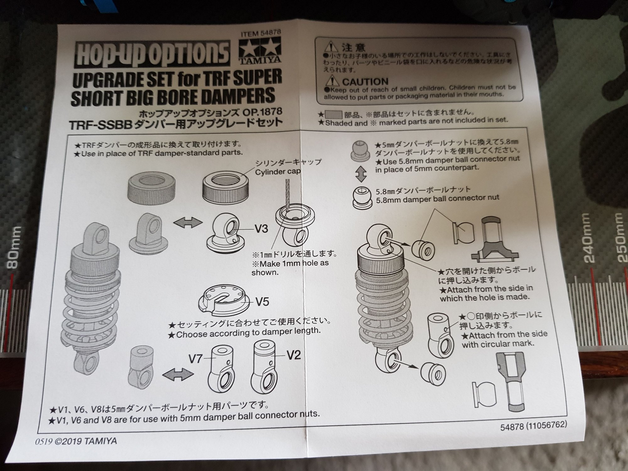

New 5.8mm ball connector nuts and cylinder caps.

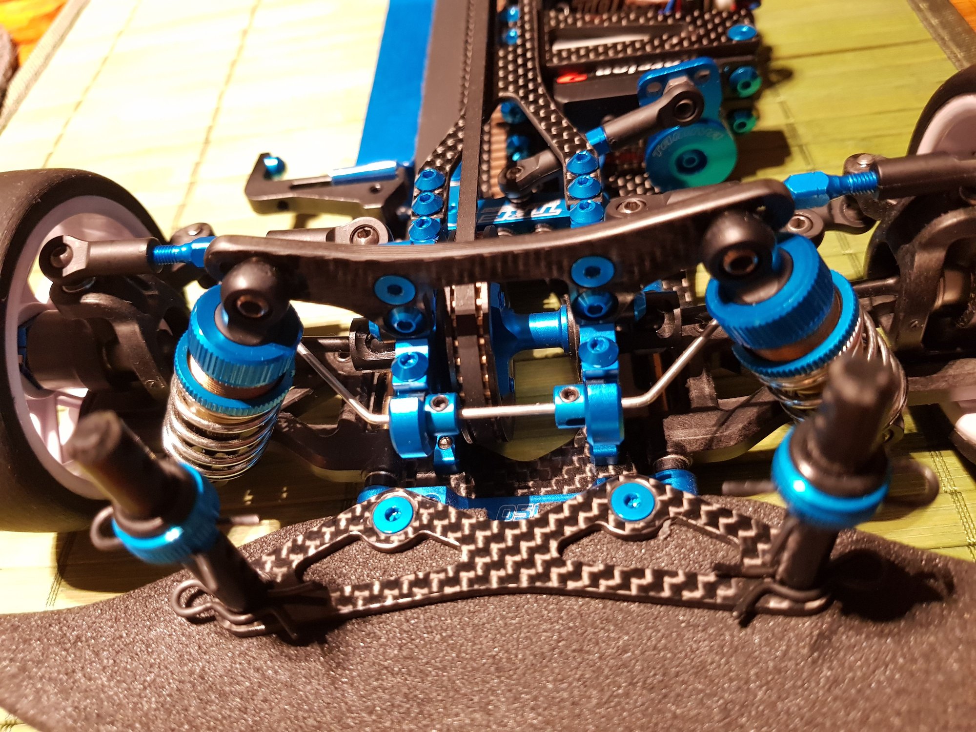

Durability is better than old system. Bleeder hole is now marked into the plastic. You have to drill it with 1mm. Plastic itself is rock hard and it's a pain to put the new 5.8mm balls on it. You have to use the long V-parts for the 419x arms because of outer hole position, or damper retainers will collide with lower arms, especially in rear. But it also alters the way how the dampers work. If have to test on track, if it's good or bad.
The 5.8mm balls have little play in the the plastic caps on the axis side. I can move damper ~1mm back and forth. Don't know if this is a new "feature" to become dampers more free in movement or its a fault of first batch. Other tolerances of parts are very tight.

The new 5.0 balls that came with 419x were already great. I wonder why the change from 5.0 to 5.8?

Don't know why...but plastic tree has parts for 5.0mm too. But then you have to use the original black cylinder caps. You have then a choice.
Part V3 for 5.8mm has other dimensions than original part for 5.0mm and it sure makes damper unit more rigid.

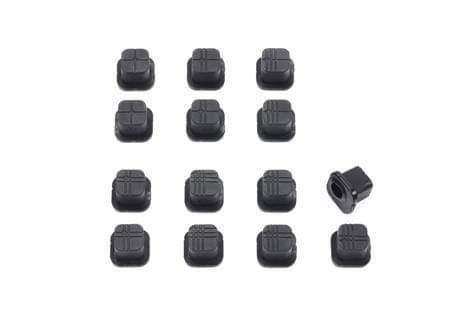

Tamiya #54922 - Adjustable suspension mount inserts
Now you can imagine, what is coming soon...
Seems there are only 3 main suspension blocks left in the future - A, E and XB. All further settings will be made with the inserts.
