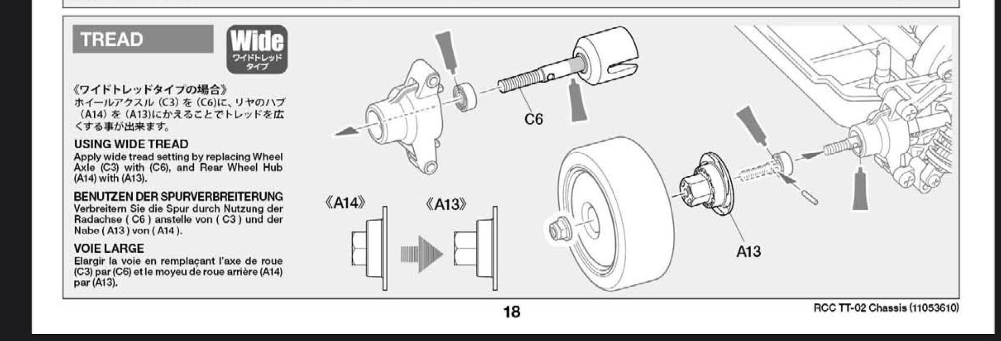

Ive been looking at the manual it looks like the disc brakes is a plastic piece that makes the car wider. Seems to be the only part. is that it or am i missing something else?

The wider plastic hex/disc when used with the stock axles, you'll find you dont have enough thread to mount your wheels. Tamiya sells a TT02 parts tree that includes the wider axles. However, only one is included per pack. I had a friend confirm that the TT01 axles work, and they sell a pack that includes two of the longer axles.
Yes, this is the stock solution.
