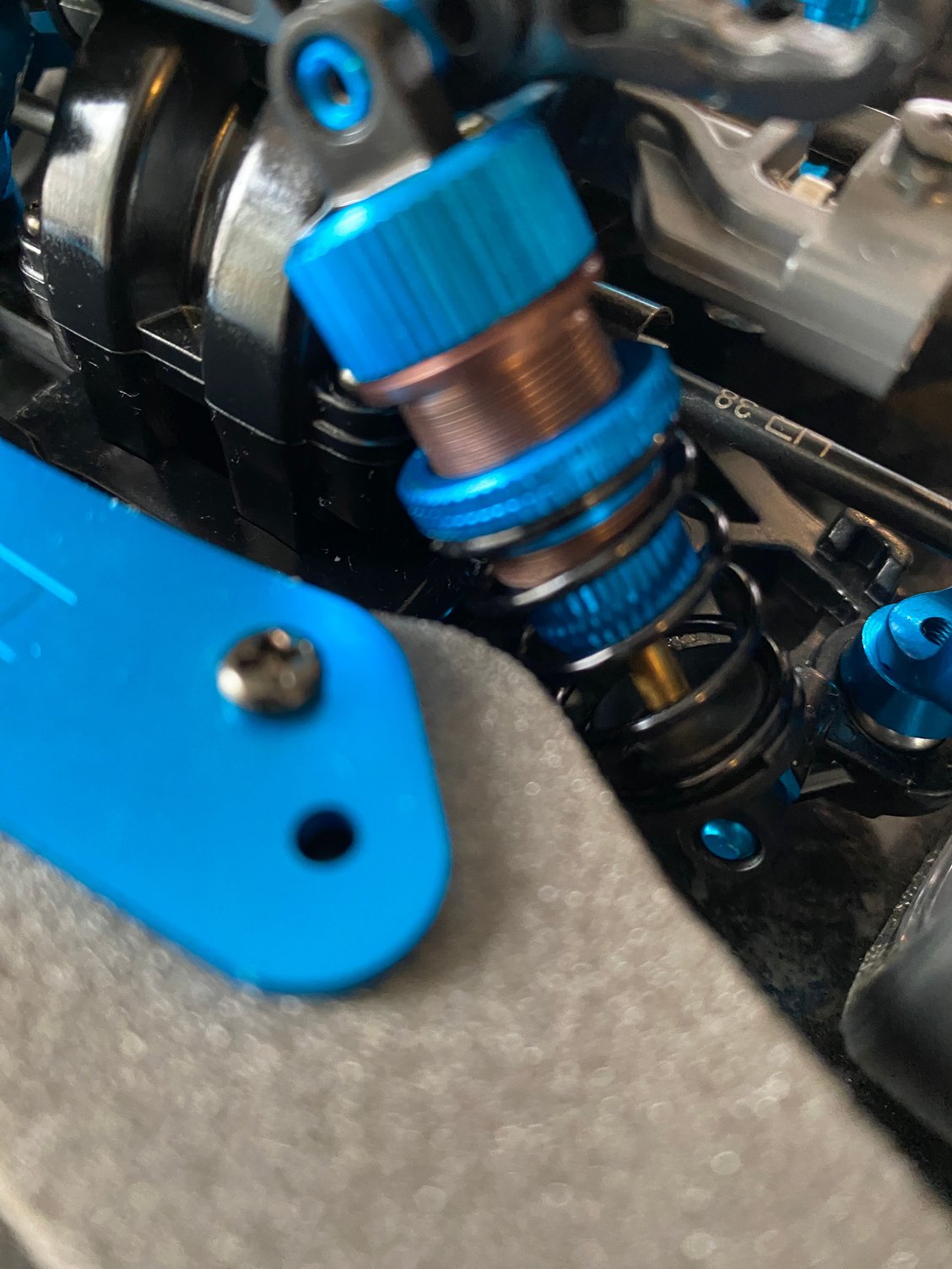

Installed some YR 55mm shocks and just to get the included springs to even touch I have to adjust the collar all the way down. Looking through the thread most people have the collar near the top. Reluctant to buy any more shocks till I figure out why. Should I just buy longer springs? Can’t see a benefit if I’m adjusting all one way.

Can you post a picture? I run the 50mm on my 3 tt02 and to get a 5mm or so ride height, I only have to them about half way or so depending on the car and its weight.

https://cimg5.ibsrv.net/gimg/www.rct...3d7cbcf74.jpeg
https://cimg7.ibsrv.net/gimg/www.rct...593767404.jpeg
Any higher and the springs don’t touch. I just rebuilt the shocks and there is minimal rebound as well.

What kind of ride height are you getting?

12mm with the shocks as they are.
IceBreakerCB 08-24-2024 03:00 PM
set the car down and then adjust the shocks, it sounds like you have the car up in the air when your adjusting the shocks.

TonysScrews 08-24-2024 10:28 PM
IceBreakerCB,
Just like with the Tamiya oil-filled shocks, you need to add a spacer under the piston to reduce the length, lower the car and reduce the droop. Once you do that, the pre-load retainer will be moved up like how you see others.
