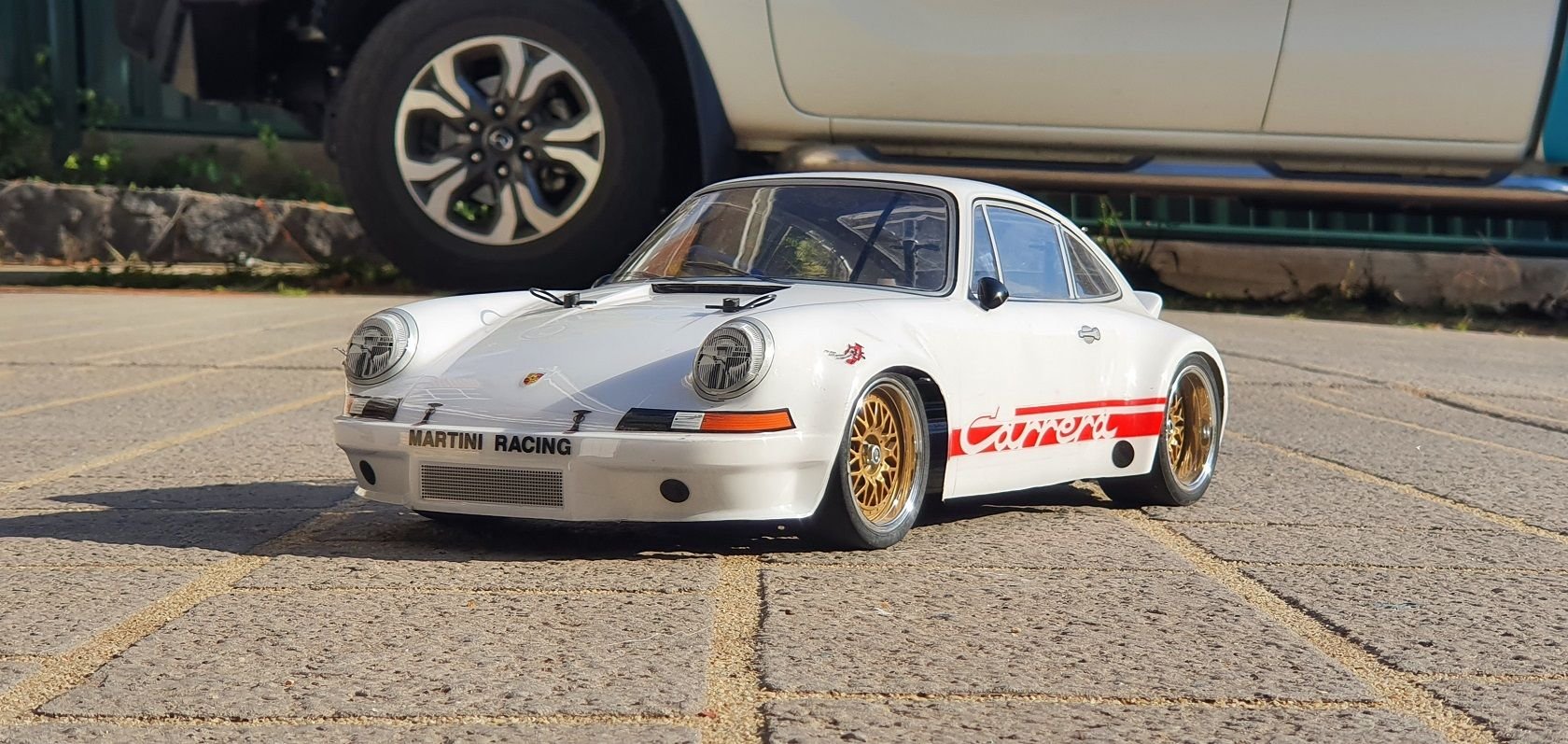

Hi all,
we've been running a TT class at our track for a few years now, and ive always raced my Porsche 911 RSR.
It has always been very loose on neutral, as in will spin out if i let off the throttle, which i thought was a TT02 trait. However I swapped with a fellow racer at the end of the day- Nissan GTR 58625 and it was planted.
Does anyone know why the difference? Cars are both stock except for bearings and his has oil shocks, New kit tyres on both and my drivetrain is very free.
Is it the shocks, 911 wide tyres or wheelbase? or maybe something else?
Thanks!
PFA
simple likes this.

Oil shocks could make a difference and what is the other guy running for diff fluid or grease?

It’s a weight transfer issue. You need to reduce droop in front, so that when your off throttle, not too much weight is transferred to front causing rear to loose traction. You do this by adding spacers inside front shocks.

For a box stock set up (friction shocks and all) I would say to switch because of the wheel base first making the biggest change. Any Tamiya body with a rear wing is also going to help a ton. The Raikiri is the best imo. The BRZ GT300, Ferrari 458, GTR, STI are all very decent or a 04 NSX lid if you can get ahold of one. Use a set of 26mm wheels as well, all the way around and see how it goes.

He is using the stock "spring holders", so adding spacers could be tricky 😉

It is indeed the crappy stock shocks, the crappy stock tires and the short wheelbase as well!

No matter what kind of racing you're talking about as has been said so often it's tires, tires & tires. I would listen to Raman he's a very experienced Tamiya driver and his suggestion may be an easy improvement.
