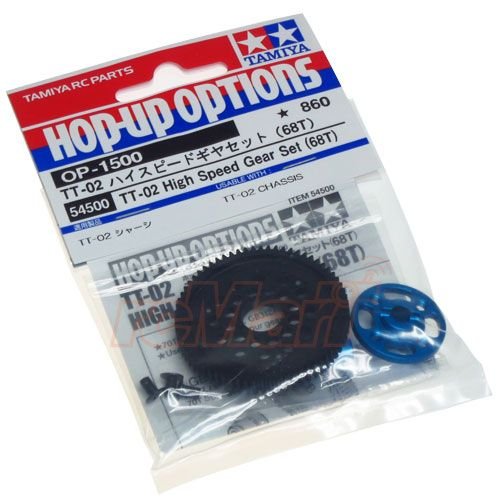

Does anyone know what the internal gear ratio is for this car? Trying to figure out a starting ratio for my local outdoor track Galaxy Hobbies...

Internal gear ratio is 2.6

So you pretty much have to do the lowest FDR allowed 64/29, and you’re still way off. Normally you would run around a 3.8 for your average size race track but thats not GT Prospec legal. 64/44 in a perfect world.
Can you use an Xray T4 gear maybe or probably not legal huh.

What you need to do is ditch the Tamiya .6 module gear set all together. So buy the Tamiya "high speed gear set for the TT02" Which all you really need is the alum adaptor for the spur (don't use the supplied .6 module spur) Then buy a yeah racing adjustable alum motor mount and convert it to 64 pitch. You will need some wild gears to get it close to 3.8-4.2 FDR.. like a 80-82 spur spur and 50-53 pinion.

This is a great inexpensive option if you want to be able to give people a great intro spec class with a car that does have options to move to other classes that needs more flexible gearing. Unless your racing a TCS event this is a great option.

Absolutely! I almost want to take my box stock TT02 posted above and swap it out for a proper 64pitch FDR set and see what a stock kit geared can really do lol..

Thank you for the info, that will help me down the road if I run a non TCS GT Pro Spec race but for this build its not legal to make those changes. It looks like we are stuck with the 64/29 combo. This was just a cheap and easy second class at one of my local tracks.
  1. Spur Gears permitted: Tamiya TT-02 stock and TT-02 Tamiya speed-tuned spur gears are allowed. TT-02: Stock 70T, Speed-Tuned 68T and 64T
  2. Pinion Gears permitted: Pinion gear ratio options shown in the TT-02 kit and the speed-tuned gear set motor mount chart instruction manuals may be used. Finding ways to exceed the maximum gear ratio shown in the manual charts is not allowed. Maximum gear ratio from the speed tuned gear set: 5.74:1 (64T Spur-29T Pinion)

Oh didn't realize you were going TCS spec... then yes you are pretty limited and far away from desired gearing.
