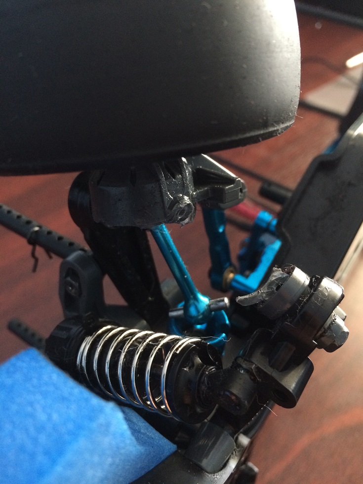

JohnyT 10-18-2014 02:27 AM
I've had a couple of evenings on the track with my TT-02D and one of the front knuckles have cracked already. Didn't take much of a knock to do it. I'm wondering if the grey A parts that come with the 'D' are weaker than the standard black parts.
Think I'll be using aluminium ones from now on.
addicted2blue 10-18-2014 02:54 AM
I'm pretty sure that your steering block broke on the underside of the steering block, am i correct?
To avoid that i've done the following.
I build my TT-02 as a rally version, meaning that you flip the rear uprights upside down and at the front replacing the spacer from the bottom to the top of the steering knuckle.
This can be done along with some TRF mini dampers or with some super mini cva dampers.
So far i haven't broken a standard steering block anymore, it's because of the spacer that sits for onroad racing bellow the steering block that it brake's to easily.
It's causing a weak spot to the steering block, that's just my experience with the TT-02 steering blocks.
Just my 2 cents opinion;)
JohnyT 10-18-2014 05:16 AM
Here's a shot of it. I think it ties in with what your saying. The break is exactly round that spacer.
http://www.computerjohn.net/drift34.JPG
addicted2blue 10-19-2014 09:27 AM
Everyone that has broken a steering knuckle from a TT-02 looks Always the same as your broken one.
That's why i changed it.
