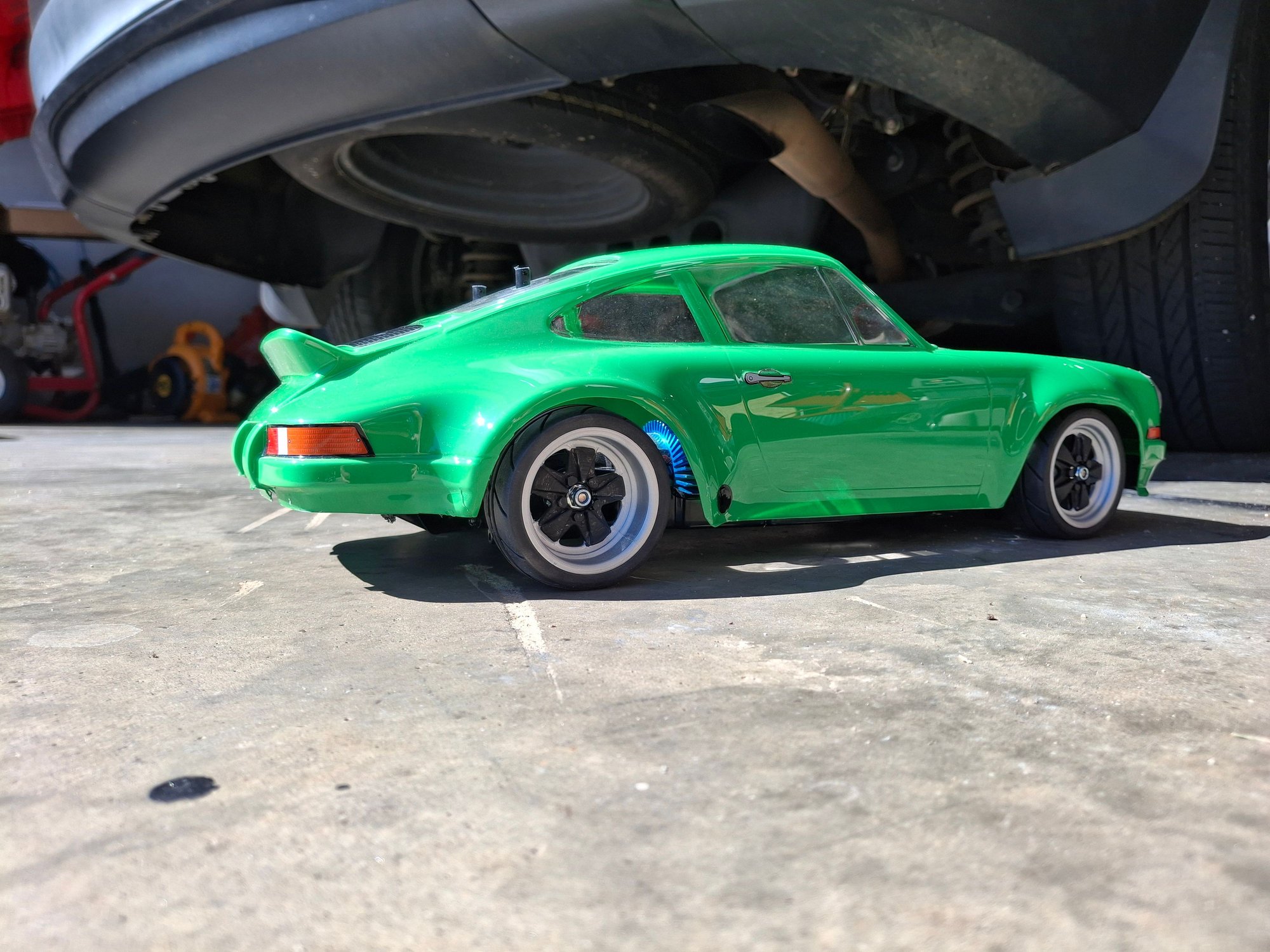

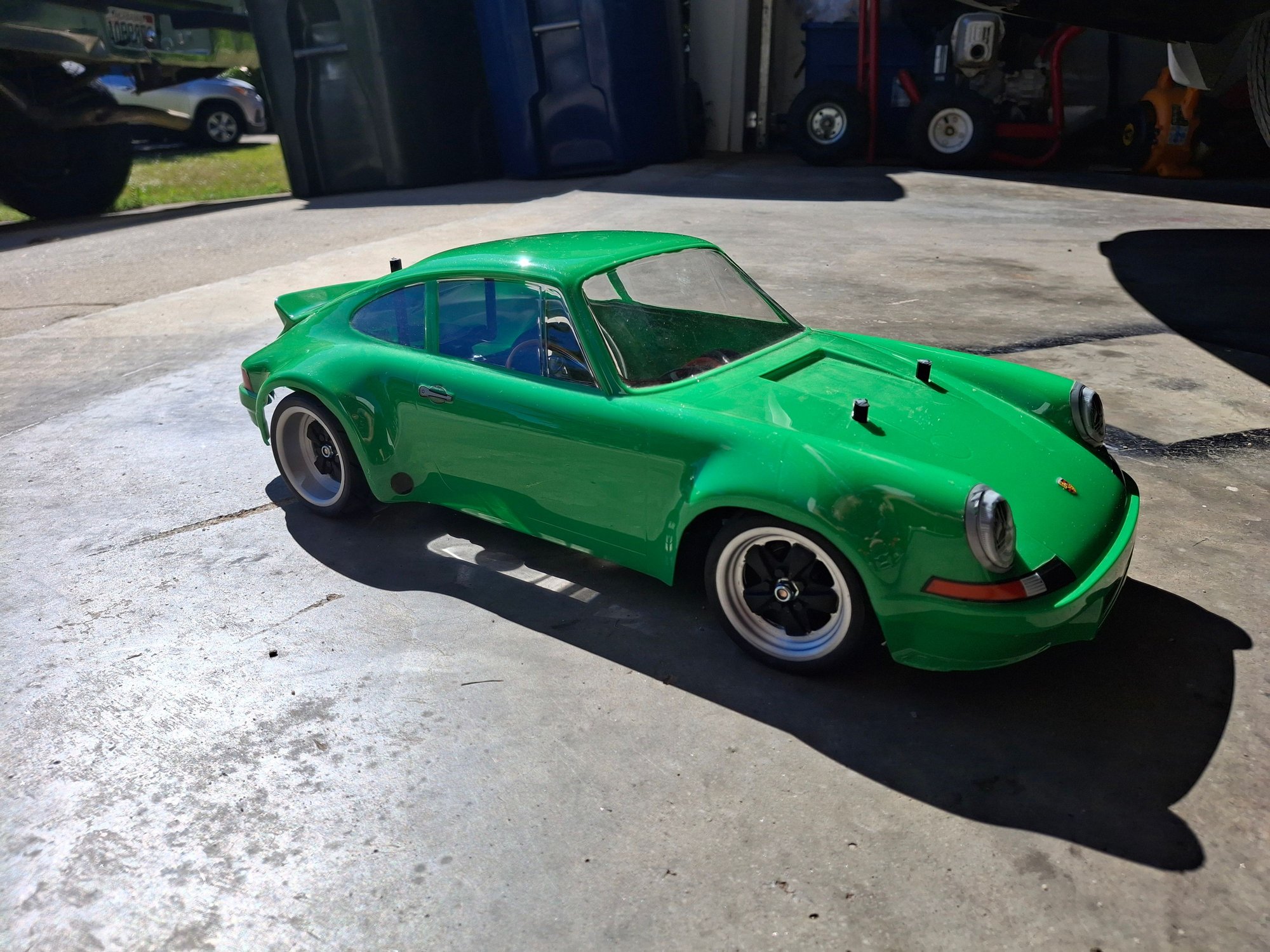

St. George 05-14-2026 02:10 PM
TT-02 911
My TT-02 is finished for now. Special thanks to the guy who uploaded the Fuchs wheels to Bambu Studios.https://cimg8.ibsrv.net/gimg/www.rct...afc6685ebb.jpg
https://cimg1.ibsrv.net/gimg/www.rct...4918afc01e.jpg
https://cimg2.ibsrv.net/gimg/www.rct...28247d9c95.jpg

AnRCGuy 05-18-2026 03:17 PM
That looks smashing! I have the Carrera RSR that I built a chassis up for but haven't done the body just yet. Those 3d printed Fuchs wheels look spot on, I'd say even better than the tamiya ones
