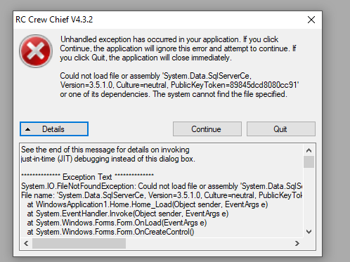

Thanks to the links Rcmax and Olivier, I was able to download and unzip vs 4.3.2 and install both 32 and 64 SQL on my Win 11 box, but getting an error when running the exe that "home form database access is not allowed"? Tried compatibility mode with same error.
Both SQL 32 and 64 installed as far as I know correctly. Any thoughts?

Its working! For me to get it to work I had to download SQL Server Compact 3.5 SP2 for Windows Desktop which can be found at: microsoft.com/en-us/download/details.aspx?id=5783&WT.mc_id=DOP-MVP-37580
Note: when you first run the .exe, it will extract the needed installers to your specified location, so make it Documents or Desktop or something, then, install the x86 msi first, and then the x64 msi, after that run RCCrewChief V4.3.exe and check if it works!
