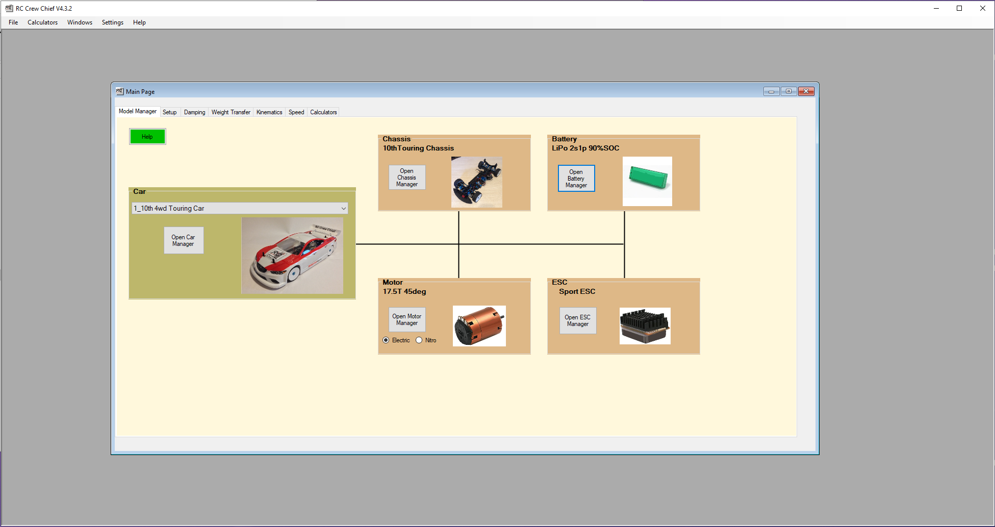

I have uploaded my working version of rc crew chief at my github account (rcstar6696)
In the readme.md file you can see a short decription how i can start and use it. It will only work if all system requierments and all programms to use it are installed on the computer you unpack it. Sadly there is no list of needed requierments somewhere.
Sorry i have not found out how to repack it as an installerpackage but i hope its ok for all like it is.
Not sure if its allowed but i link it anyway (remove the /// to open the link)
h///ttps://github.com/rcstar6696/RCCrewChief_ReUpload
i hope Bob will be happy that we contiune using his amazing work

Its working! For me to get it to work I had to download SQL Server Compact 3.5 SP2 for Windows Desktop which can be found at: microsoft.com/en-us/download/details.aspx?id=5783&WT.mc_id=DOP-MVP-37580
Note: when you first run the .exe, it will extract the needed installers to your specified location, so make it Documents or Desktop or something, then, install the x86 msi first, and then the x64 msi, after that run RCCrewChief V4.3.exe and check if it works!
Great job Rcmax6696!
Edit:
You can find almost all chassis, motor and esc files at: web.archive.org/web/*/http://www.rccrewchief.wrightdesign.ca/*

Works for me too! I had to reboot after installing everything but it seems to be running. I just need a rainy day to start watching Bob's videos all over again.
Many thanks!

It works here too!!
Thank you very much Rcmax6696 .

Same here, thank you Rcmax6696.
Very relieved that we are able to continue to utilise Bob's great work and effort that went into the software, it's been an absolute staple of my racing for many years.
