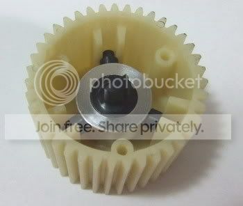

It's two-up Tuesday! (except it's Wednesday..) Either way two updates in a single day is a record of sorts.. So you can tell that Tony isn't pushing himself all that hard at work today.
So...whats this part? Click here to check out the Tech Racing Spool conversion for your M03.

Funny, I saw those for the first time today on rcmart. I'd always heard that completely locking the diff in your mini was a bad thing.
I did have a little personal experience regarding this a few weeks ago. I built a new ball diff, loaded it with anti wear grease and cranked it down. It was essentially locked.
The car handled like crap! If one wheel got a little grab it would pull ahead, changing the suspension geometry so the other side would grab, and so on and so on...the car fishtailed a little.
I suppose if you are racing on the right surface it could work though.

When I was heavy into 1/8 nitro onroad ten years ago, no one used a diff. We ran solid rears and one-way fronts. Of course we had gobs of power and couldn't afford to lose traction getting the power down in the corners.
Now, if someone could make a Torsen diff for the M03...
