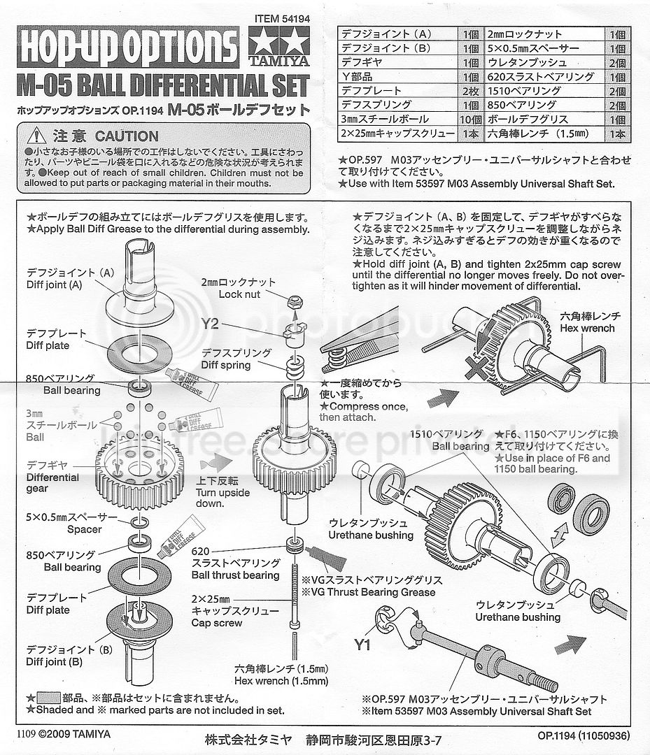

KA2AEV 01-31-2016 02:22 PM
Hey since we're on diffs
Does anyone know if the part Y2 in the above drawing comes in metal or aluminum???
I was just doing some basic PM on one of my Diffs and found a hairline crack in it
Core Creations 01-31-2016 02:37 PM
I'm assuming something like this would work...

KA2AEV 01-31-2016 07:51 PM
http://www.tqrcracing.com/shop/produ...FRApaQodbu4EZg
Yeah that would, I'm guessing that's aluminum or some type of cast right?
