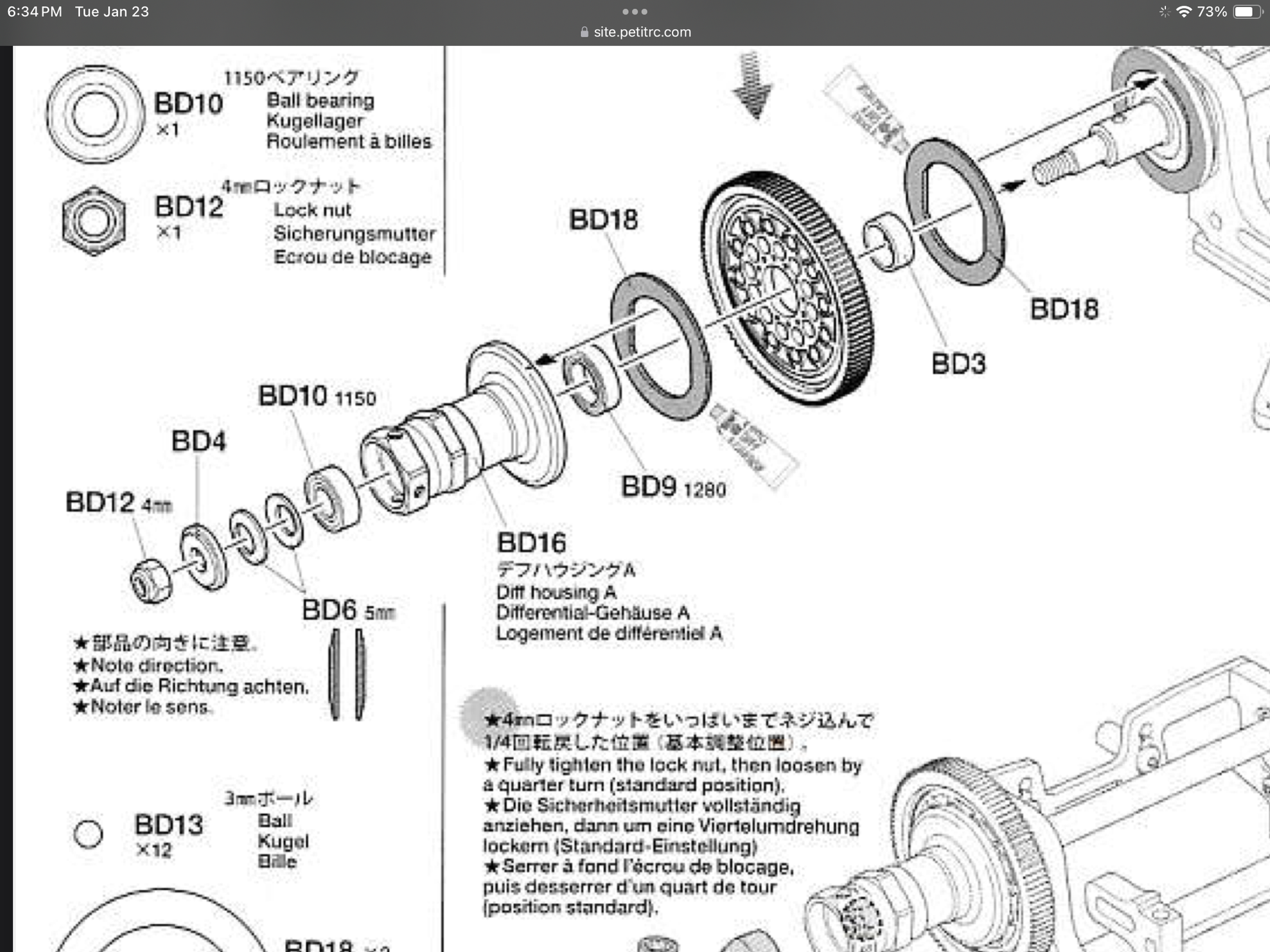

This is only my third ball diff build and it doesn’t seem correct. I’ve torn it down and rebuilt it three times now and each time it presented as built correctly and still doesn’t feel correct. It’s set to the manuals setting but it’s notchy but more importantly the spur gear floats which changes the mesh with the spur…is this correct? Thank you in advance.
Acid_CZ 01-20-2024 10:14 AM
Check if all the washers are seated correctly. Floating spur is correct.
The cure for a notchy Tamiya diff is a simple one, and to this day, I don’t understand why Tamiya continued to supply a radial bearing where a thrust bearing should be in their premium F1 kits.
Replace the BD10 bearing with Tamiya part # 53136 one piece thrust bearing. Lube it with black grease, and reinstall with the BD6 spring washers in a “)(“ pattern rather than () as in the instructions.
That will cure the notchiness.
As said above, the float is a good thing, and an indication that the rings are riding only directly on the balls. Not an issue.

Thank you for the help and the thrust bearing suggestion was perfect. Very smooth now.
