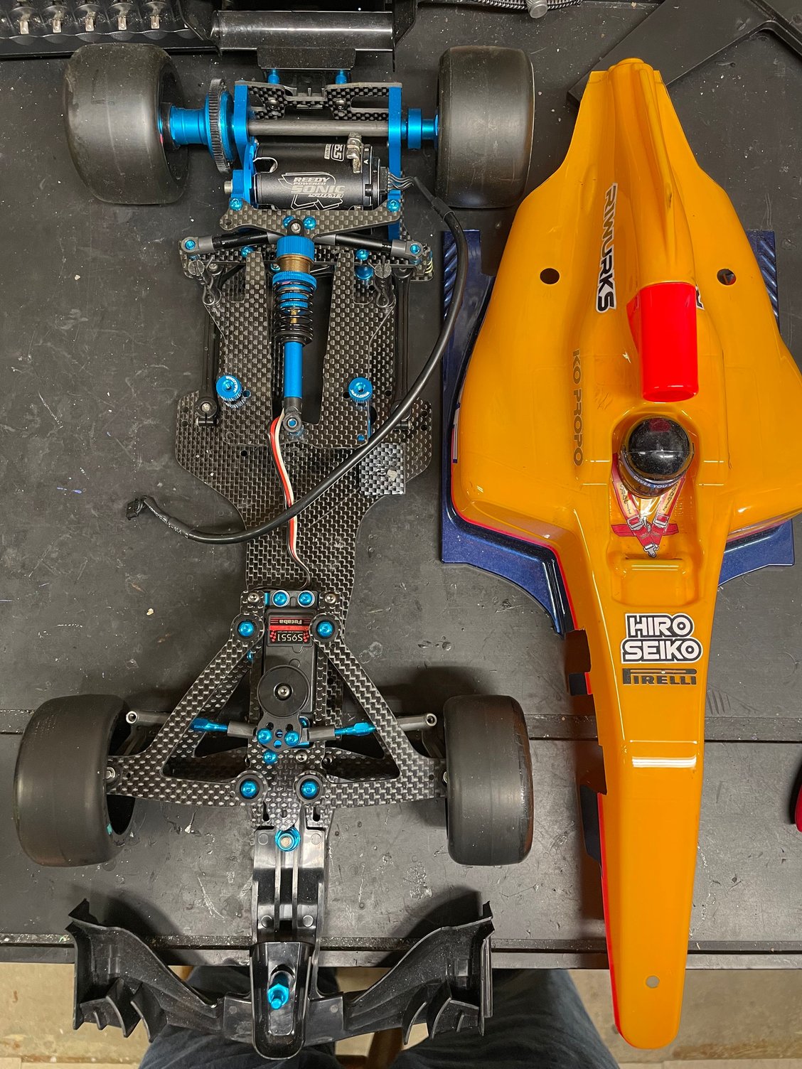

StockRc 04-20-2022 06:10 AM
Found one Now not sure I’ll have time to run it…lol. Suggestions on set up Upgrades and electronics? Thanks
Jonnydb 04-20-2022 09:07 AM
Originally Posted by StockRc (Post 15896901)
Found one Now not sure I’ll have time to run it…lol. Suggestions on set up Upgrades and electronics? Thanks https://cimg9.ibsrv.net/gimg/www.rct...3c6f45df3.jpeg
congrats!! its a great car!
for update i recommend the gear diff besides this, dont need just make a maintenance and run to win :lol:
for setup, recommend start with Simon Lauter setup
