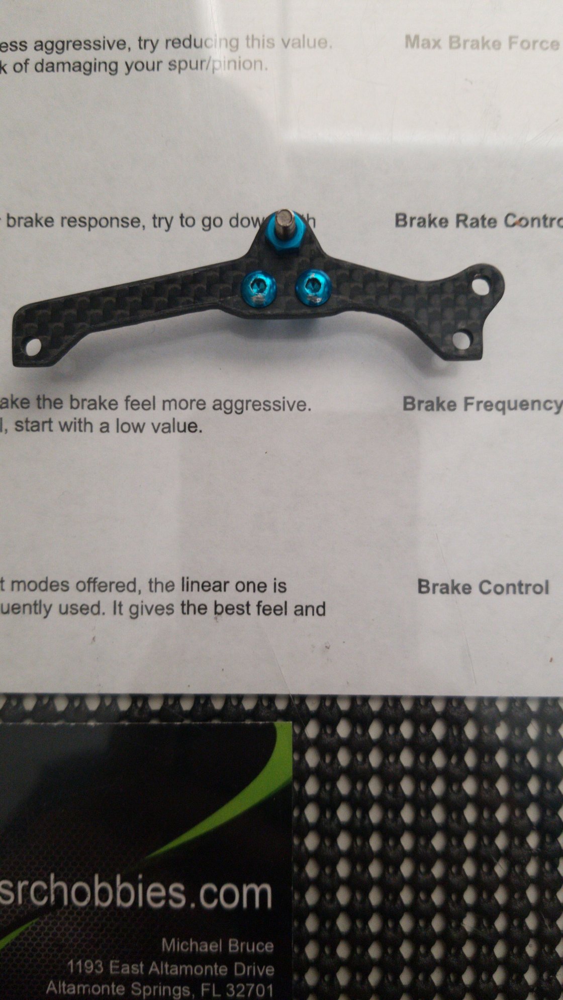

sonic31 04-21-2019 05:37 PM
I hate the top plate on this chassis, so .....https://cimg1.ibsrv.net/gimg/www.rct...821893b36.jpeg
https://cimg8.ibsrv.net/gimg/www.rct...02580d6327.jpg
sonic31 04-22-2019 12:49 PM
A small modification to the motor mount top plate, i needed the motor terminals to sit a certain way but the top plate was hitting it so ....https://cimg0.ibsrv.net/gimg/www.rct...986c23fab.jpeghttps://cimg7.ibsrv.net/gimg/www.rct...3477e633c.jpeg

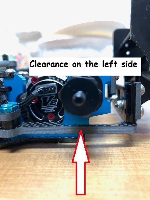

For those who PM'd me about the rear Xray pod, I am posting a few pictures with notes of how it was installed. I don't know of a direct fit kit yet for our TRF103.

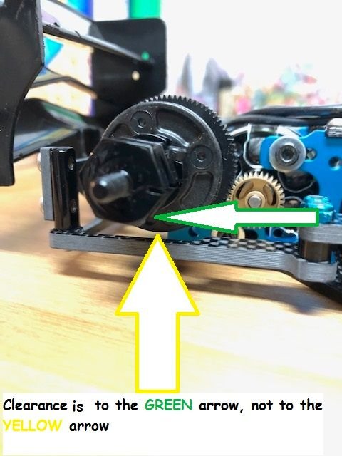

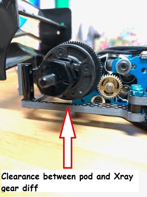

On one picture with the gear diff clearance, you guys asked how close the gear diff is to the plate. The plate has a cut out to avoid all diffs so it will not hit or rub unless you go off-roading or crawling
https://cimg2.ibsrv.net/gimg/www.rct...c47e5b2ed6.jpg
https://cimg1.ibsrv.net/gimg/www.rct...792f1e9203.jpg
Dan 05-03-2019 11:14 AM
Could you use a larger black spacer to move it further down?
