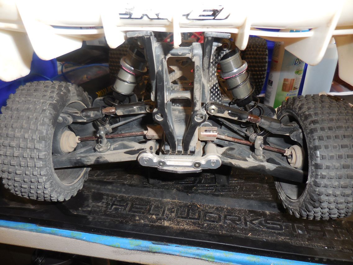

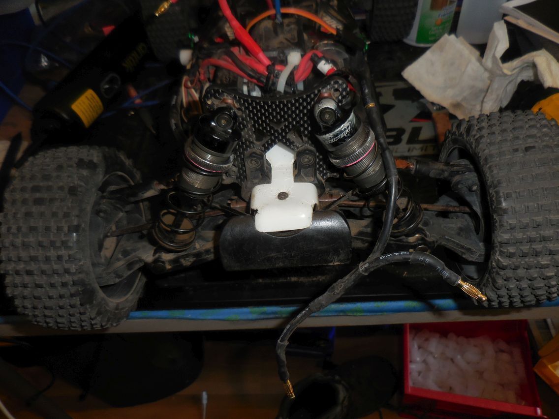

There is no quick way to know exactly what version you have, but if you post a picture people should be able to help you out.

In doing that work, i found that a lot of the screws aare metal going into tapped plastic. I'm not a big fan of that although i guess it is fairly prevlent in RC cars. I get screws coming out of the front end (mostlt steering) and the manual does not call out thread lock. I am using a thread lock rated for plastic called VC3.
I am pretty sure the version is the original 2011 ersion but maybe not. Here are some photos
