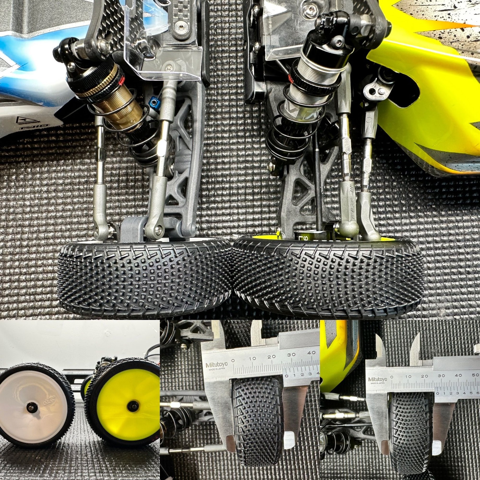

Comparison
4WD Fuzz Bite Front: 27.3mm W x 8.5mm H (sidewall)
2WD Fuzz Bite (Wide) Front: 26.2mm W x 5.5mm H (sidewall)
I was able to glue the 2WD Fuzz Bite (Wide) Front using the Raceform Lazer 1/10 Jig w/ Carpet Conversion kit with the recommended 2WD front plates (2R+2R+5R+5R) vs 4WD front plates (3R+5R+5R). This seems to align with the slightly narrower width. You do have to 'help' the tire to start pulling back the bead, but otherwise no issue (stayed correctly peeled back and reseated the bead nicely the entire circumference).
JConcepts Fuzz Bite 2WD (Wide) comparison
