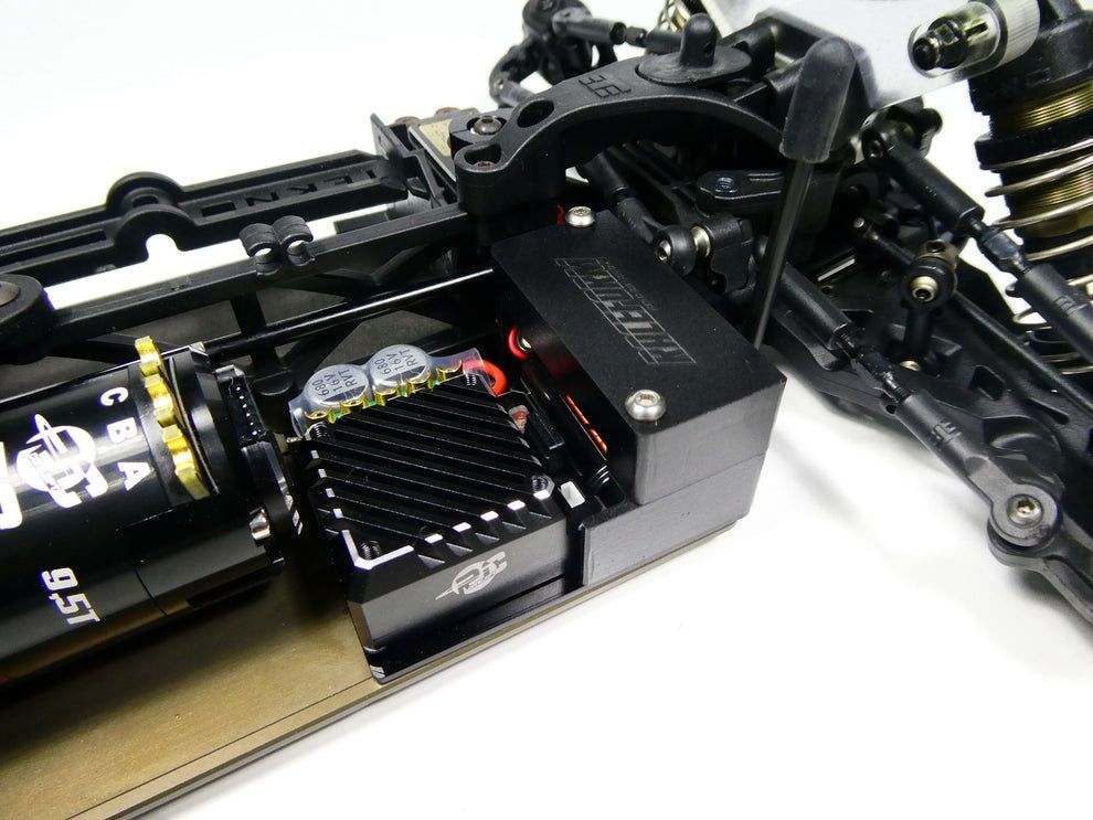

I purchased a used Et410. But it does not have a receiver box? Is do do you have a part number?
No receiver box for any of the 410 series. You’ll probably have to purchase or print a custom piece if you wanted one.
What do you all normally do?
It;s not sealed, but: TeknoRC EB410/ET410 V2 Electronic Tray – Raceform RC
