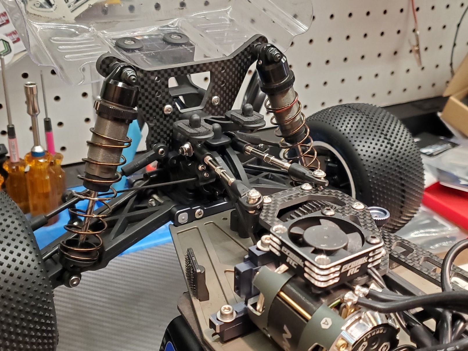

Originally Posted by Cromulent
Going to try some upper chassis braces next carpet race
Test results are in - braces suck. Major loss of rear end traction, even on smooth black CRC carpet. Both myself and my brother tried them with the same results.

Interesting... What was the original issue?

No issue, just attempting to stiffen the chassis and see if handling improved...

Have you tried with a single turnbuckles? This setup with 4 points will modify the longitudinal flex but also the torsional flex. I suppose that you would like the modify first without affecting the second.
Just my 2 cents.

No, without having the TB centered, a single TB in this install would cause uneven torsional flex. It was just an experiment to see how it changed the car's behavior, I'm still the limiting factor by far
