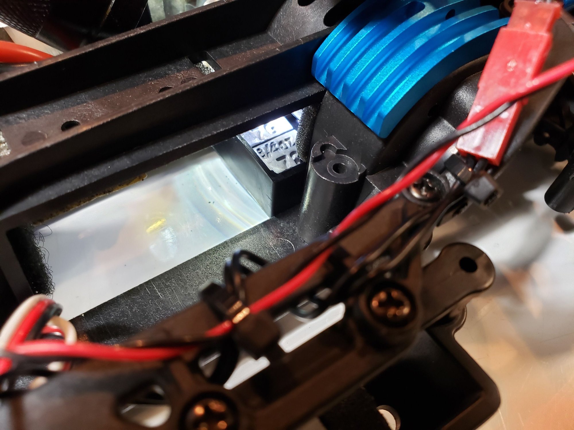

Someone asked how I mount my shorty pack battery in my M07. I realize this is an M08 thread, but the question was asked, so posting a few photos.
-As you can see the shorty battery is mounted nearly in the center of the chassis, it is slightly offset (only slightly) to the passenger side/right which is counter to the motor being slightly offset to the driver's side/left.
-I also posted a photo showing the weights I've included just under and behind the motor to make weight. I have 21grams of weight in that area, it is a great spot to put the weight as it is at the lowest point of the chassis and just forward of the center of the car.
-I also put some foam not only on both ends of the battery mount but also inside the lining of the chassis to further make the battery snug when in place. No need for tape and the batter does not wobble or slide around. (I taped the foam on the battery mount locations as it didn't seem to stick well w/ use).
