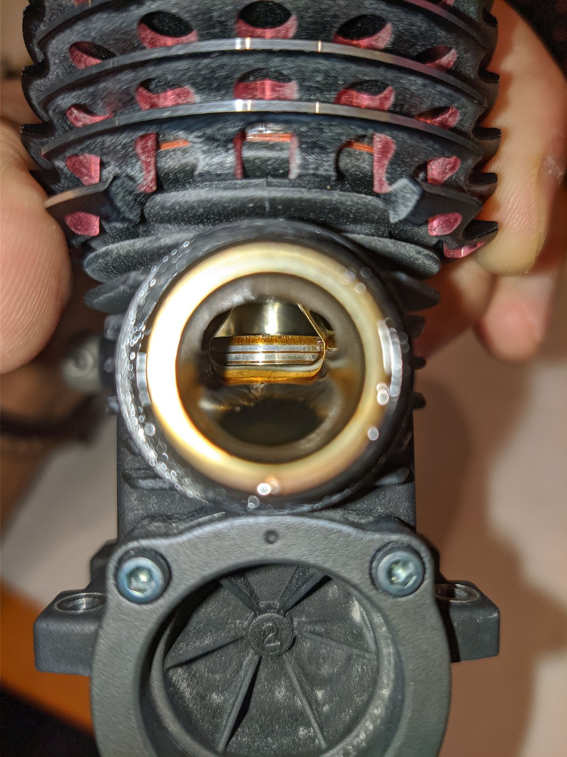

Old 11-03-2021 | 06:16 AM
  #171
Joined: Sep 2021
Posts: 19
Some pics of the inside. Is there anything weird? The rust in the glow plug is because of rich mixture?
pokabilius is offline
Old 11-03-2021 | 07:56 AM
  #172
Roelof's Avatar
Tech Lord
Joined: Aug 2007
Posts: 14,045
From: Holland
Well, it seems it is not only to the R2104 anymore.....
I saw this this morning comming by, 2 offroad engines with a same issue.
This is what will happen if you go too quick, it is showed on the exhaust side. So your sight looks so far OK.
The brown dirt looks like burned castor oil but the pic is not sharp enoug to zoom in much closer. If it is already drying up (getting hard) I would advise to ckean the inside before the next start.

Old 11-03-2021 | 08:03 AM
  #173
Joined: Sep 2021
Posts: 19
You mean clean to clean the piston? Am i doing it with wd40 and kitchen paper?
Regarding the glow plug does it need cleaning too?
