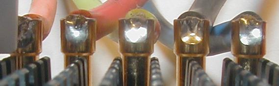

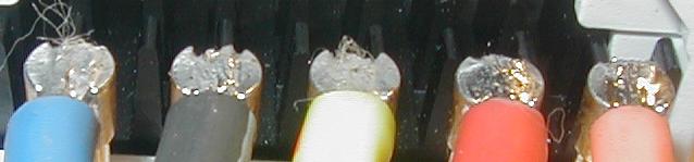

ta_man 07-27-2016 03:50 PM
Originally Posted by wrenchdoctor (Post 14615334)
Regarding the temp question, you want to set the iron to just hot enough to melt your solder. That will usually be in the 600-650°F neighborhood. For the solder i am using 640 seems to do the trick.
Why?
If the iron is hotter, there will be a higher temperature gradient from the iron to the part and the heat will transfer to the joint faster, thus meaning less time you have to hold the iron on the wire post to get it hot enough to flow the solder. That means less time for heat to flow down the post into the circuit board.
I get joints flowed like this (the wire is pre-tinned and squeezed to fit the slot in the post) from a much hotter iron applied for 1-2 seconds:
http://www.ta455.net/ebaypics/Misc/r...ed-c-small.jpg
(Forgive the fuzz :lol: - left over strands from a q-tip used to clean off the flux)
http://www.ta455.net/ebaypics/Misc/r...ed-a-small.jpg
