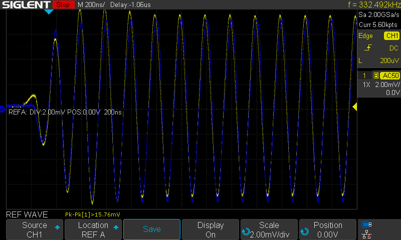

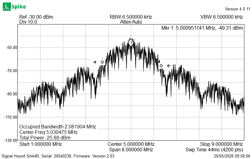

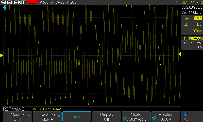

V2 TRANSPONDERS TESTED AND VERIFIED
Thank you everybody for your patience. From now on, the v2 transponder is the primary version you see when visiting openstint-transponder. The previous version is available in a separate branch (v1).
Highlights:
  • similar signal level to an RC4Hybrid
  • works down to 2.8 V supply rail
  • flat signal level down to 3.4 V (miniZ and 1S-battery is support)
  • much easier to tune, less harmonics, symmetric sidelobes
The new design was tested with ATtiny 816/1616 and 3217. I'm certain it runs on 3216 and 416 as well.
MEASUREMENTS
Signal strength (blue: RC4H; yellow: OpenStint v2; same distance)
Bit transitions:
Occupied bandwith:

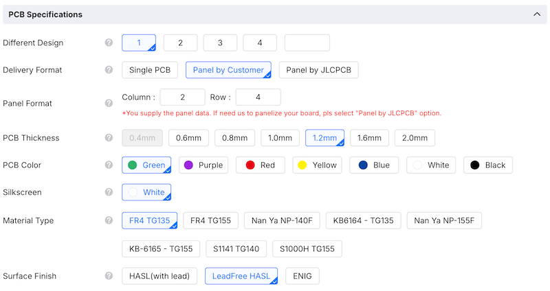

Hi,
I am trying to understand the transponder ordering & flashing process via JLCPCB. I tried to place the order via the web user interfacel.
- Delivery Format option:
If I choose single PCB I get a error message about duplicates later after uploading bom and pos files. I could instruct to ignore it, but not sure whether that is right.
If I choose panel by customer (which also sounds about right), I am asked to enter dimensions. When I enter 2 columns 4 rows, I end up with a total cost, that is above 600 USD. Doesn't sound right either.
- What are you recommending as surface finish option?
- Flashing the firmware:
I think I can take the easy way and skip the build process and directy jump to flashing the Main.hex file from the release package using the STM32CubeProg tool linked earlier in the thread (although avrdude is mentioned in github)
However, what hardware do I need to connect to the transponder? Do I need a full Atmel ICE kit? Google returns a huge range of devices.
Thanks a lot!

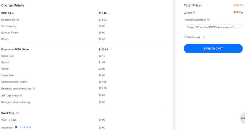

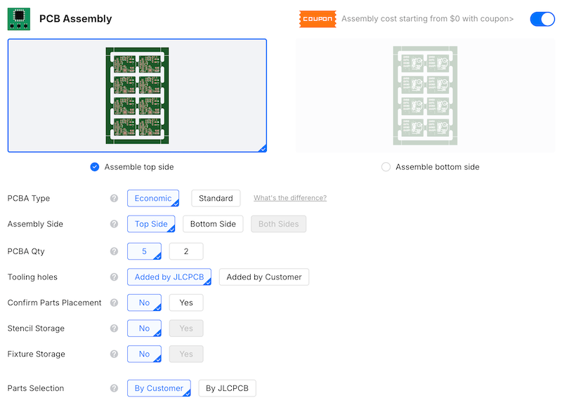

1. DOWNLOAD PANEL, BOM AND POS FILES FROM GITHUB
Go to the recommended release linked from the readme, and download the "panel-release.zip". Inside, there are:
- gerbers.zip: this describes the various layers for manufactoring
- bom.csv: a list of components to source for the assembly
- pos.csv: the position and orientation of the aforementioned components.
All of these files must be read by the manufacturer, you're not supposed to have anything to modify on them.
2. GO TO JLCPCB, REGISTER, AND "ORDER NOW"
First, you have to specify the PCB parameters. Important settings are set automatically on gerber upload. You have to change:
- delivery format: panel by customer
- panel format: 2x4
- PCB Thickness: 1.2 mm (important!)
Do not change anything else. For surface finish, HASL is good enough. Lead-based soldering is easier to prototype, and compliant/legal for diy purposes. Lead-free also works (melts differently at higher temps though).
Also tick the "PCB assembly" toggle. Defaults work fine.
3. SPECIFY PCB
1. verify top side was selected
2. upload POS & BOM; select "complete file, ...", JLC has nothing to do
3. BOM screen: is something is out-of-stock, you'll stop here. otherwise proceed
4. Component placement: there is a dot next to all components on the silkscreen (white drawing). Verify components purple dot aligns with the white dots. The LED's negative side is towards the MCU. You can correct if something is wrong.
With lead-free specs, 5 panels:
4. Save to cart, specify shipping, apply coupons, pay your taxes, etc.
disq, Speed 8, Oldfan and 1 others like this.
