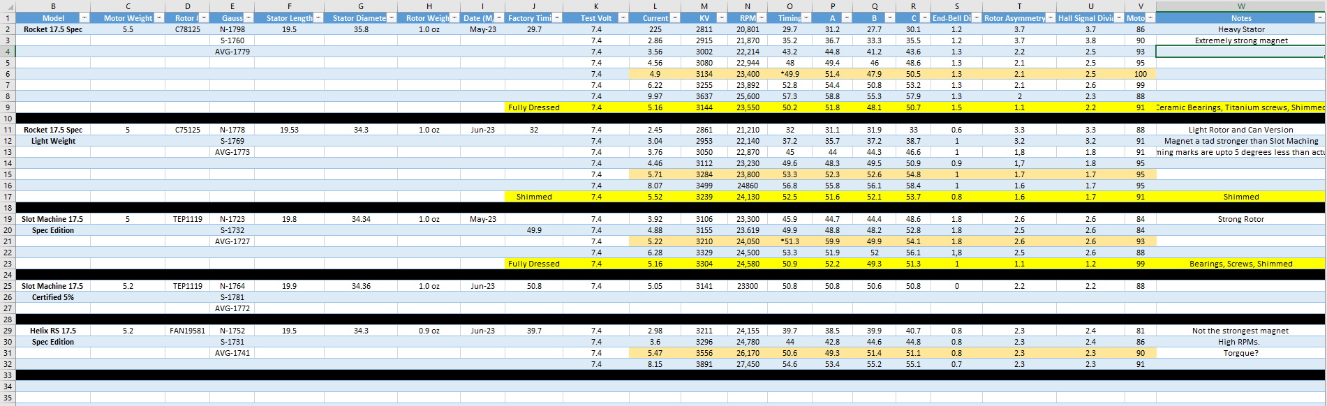

So far, here are the test results I have for the motors I tested. I'm new at doing these tests, for forgive me if something looks off. Once I get more familiar with the Motor Master, I will post results from that.

I have only tuned a few motors so still learning. I have also noticed significant improvement in the rotor asymmetry after shimming so that the rotor is a little closer to the Hall effect sensors (but not so close as to risk touching). I assume the shimming does not improve the rotor performance, just improves the consistency of the rotor triggering the sensors. Then again, Electromagnetics was my worst subject in college 40 yrs ago

Yes, that is accurate. I messed around with shimming and found that the motor doesn't always run better if you shim the rotor closer to the endbell. The asymmetry goes up, but the amps go up and the rpms go down.
