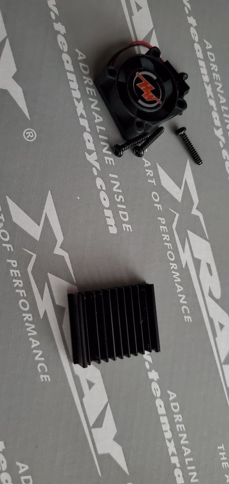

hello just purchased this pre-owend and the heatsink was not attached. Is the heatsink attached to this esc with just double sided tape? If so which is the best to use?

In the manual and on the product page there is nothing about an heatsink and fan, I suppose that does not belong to it.

Ive never needed or used one on that esc. It never got hot enough even in texas heat. They just dont run hot so i wouldnt worry about getting it on. If you really want to put it on you would need computer thermal tape. Servo tape doesnt conduct heat and would in effect trap heat in it.
