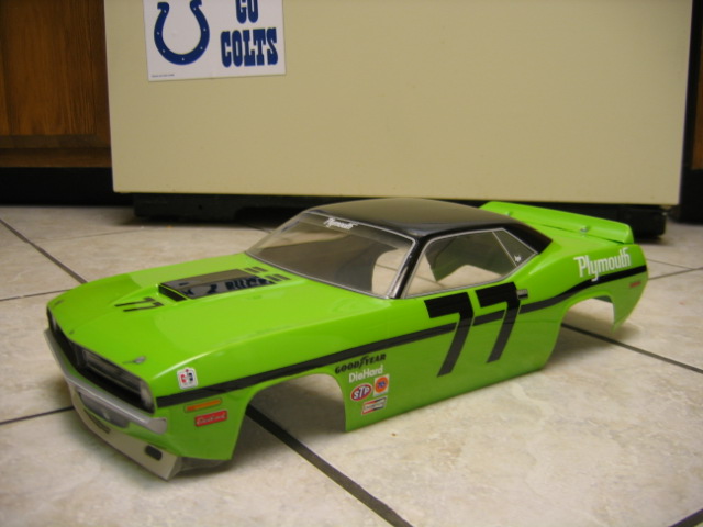

What did you do to prep the body? I used Model Masters and it flaked off! I heard there is an automotive etching compound that a few guys have been using before painting. Did you use it?

If you choose to use the Testors Model Masters paint on lexan bodies, make sure to use the Lacquer paints and not the acrylic or enamel paints. Here is a link to their Auto Lacquer Paints (http://www.testors.com/category/1369..._Lacquer_Paint).
As far as body prep, I always clean out the inside of my lexan bodies with warm water and dish soap. In the case of the 'Cuda I scuffed up the inside of the body with the Scotch Pad side of a dish sponge. Make sure to not scuff up the clear areas like windows.
I always paint with rattle cans. I make sure to paint in light coats, especially the first coat of paint. Between coats I use a hair dryer to speed up drying.

This is a variation of the #77 Challenger driven by Sam Posey.
Body:
HPI '70 Cuda
Paint:
Model Master Lacquer - Sublime Green
Pactra Outlaw Black
Notes:
Side numbers & pin stripes are painted on inside of body.
That Looks good
