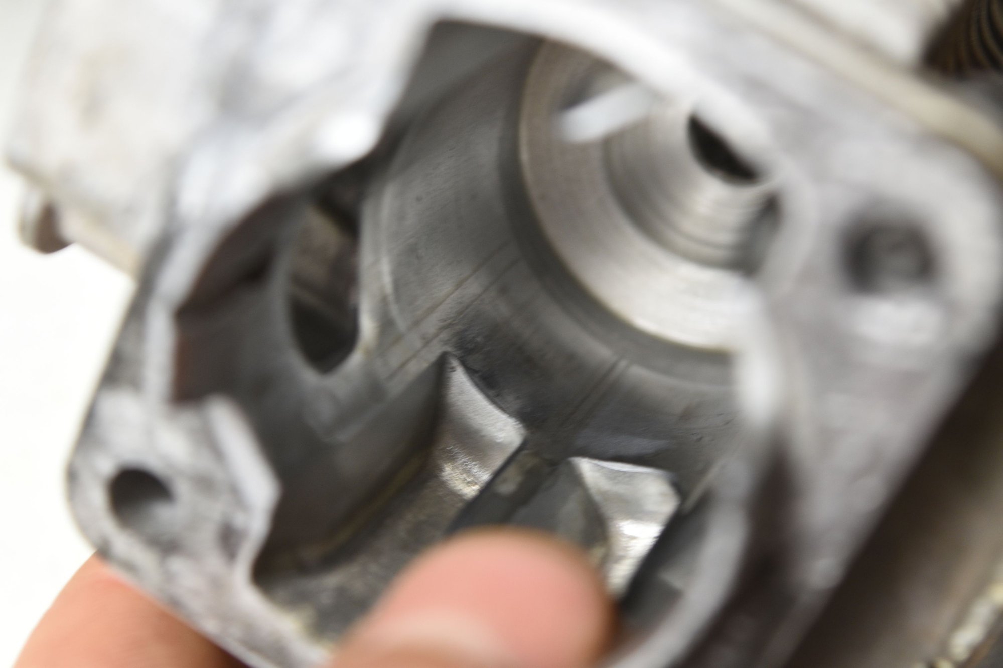

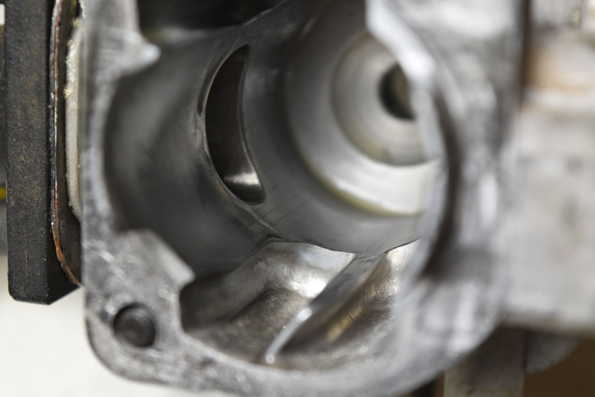

I re-ring, change gaskets and clean/rebuild carb every season. Cheap insurance in my mind. When you feel a loss of compression you will obviously open her up. If you see major scoring/scratches in the cylinder then you'll need a new head kit, if there isn't anything majorly scratched you can re-ring.... I'm waiting on a couple of rings right now for my 27.2cc, the cylinder shows some scoring but should be fine. I'll post up a pic of the head I'm working on so you have better idea.

Not that I know of. These motors are nowhere near as finicky as the nitro's. They should hold a tune until you change gas or oil mixture. Of course if you tune in summer it's gonna want different settings in the fall/winter. Typically if I experience your issues it's a gasket somewhere or dirty carb.
Here is a photo of my 27.2cc that I'll be re-ringing soon. This will be the last refresh for this top end I think. Notice the scoring lines. They aren't too bad but that is the beginning of the end for a cylinder. If you can get a finger nail into one of those grooves than it's prob time for a new head.
