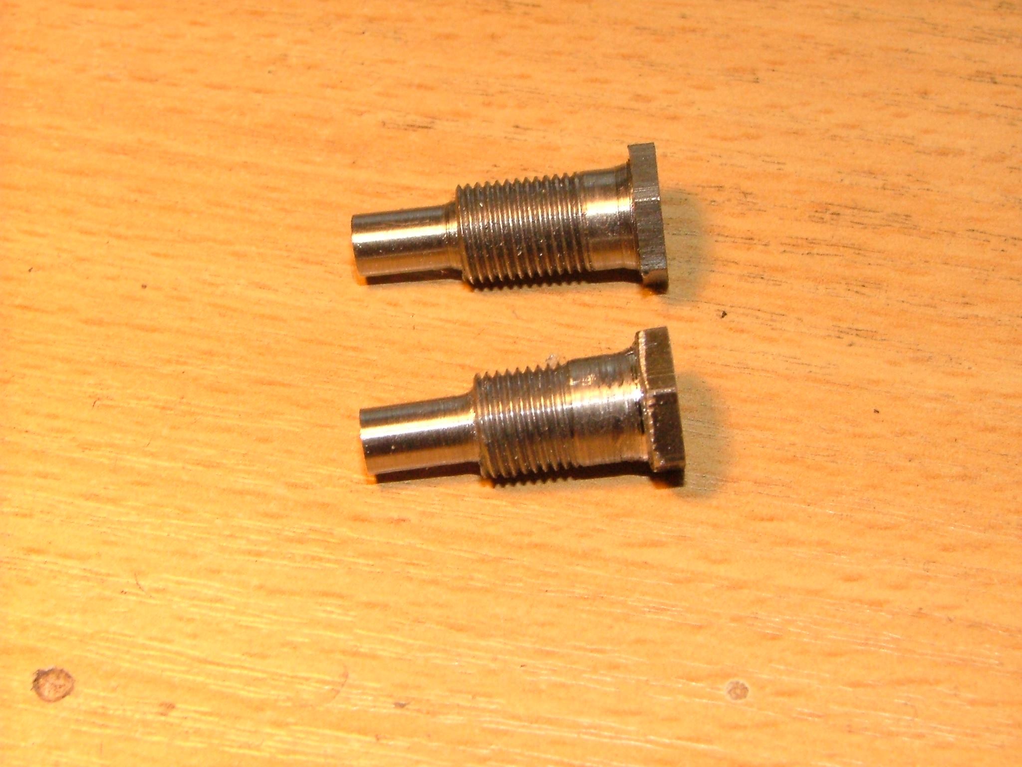

I am busy with building up the perfect rain engine but it has no SG shaft, only a threaded OS shaft. To mount a Centax type clutch I made these shafts out of a bar of 10mm hex shaped steel. It is like the original flywheel nut but with on top a 4.95mm shaft for the clutchbell.

Roelof, are you willing to sell me two of those?

I can make some... which thread? M5, M6 or 1/4"-28 ?
