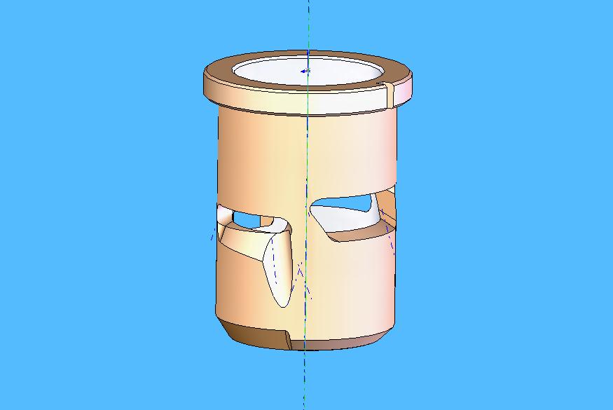

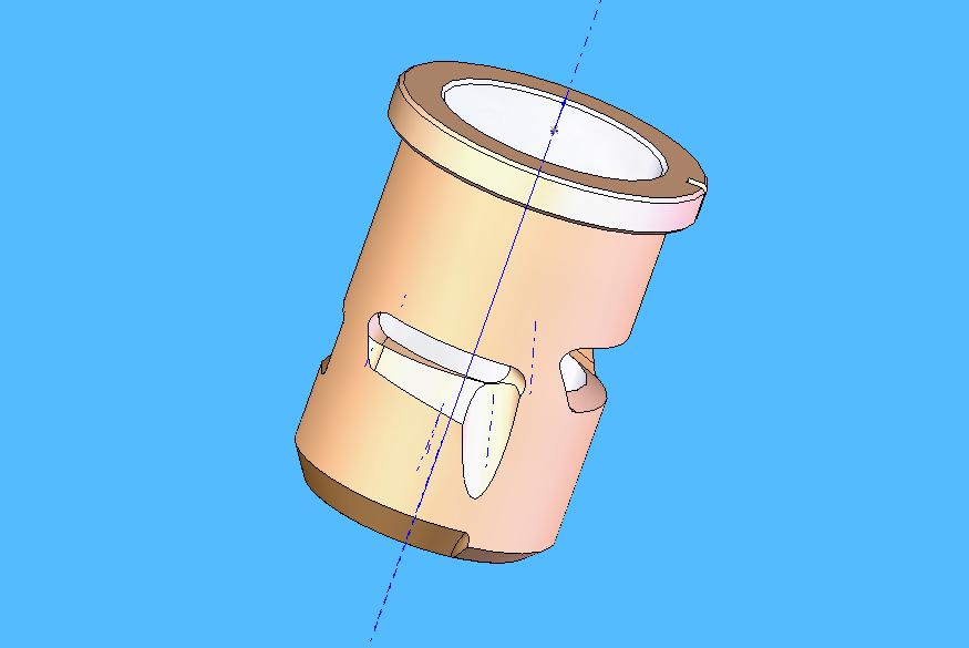

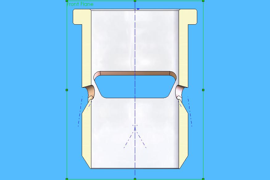

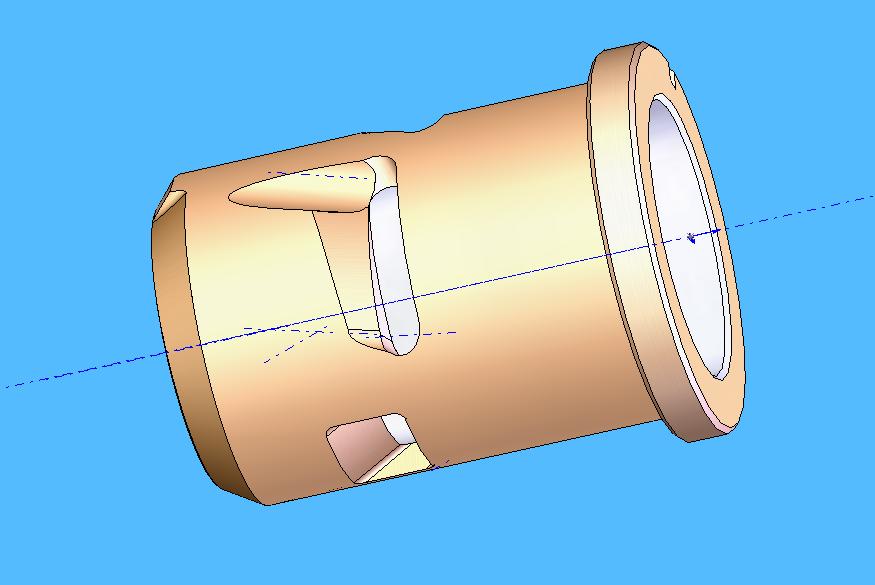

I hope this pics (diviation analisis is included on last pic, just maximise it) will help to anybody who wants to modify their engines.
Use dimond bits from Dremel, don't use tungsten.
Good luck.
Edward
Good luck.
Edward
those are very helpful.. thanks..

after looking at the last image show the min and max angles, how would you go about measureing those?
