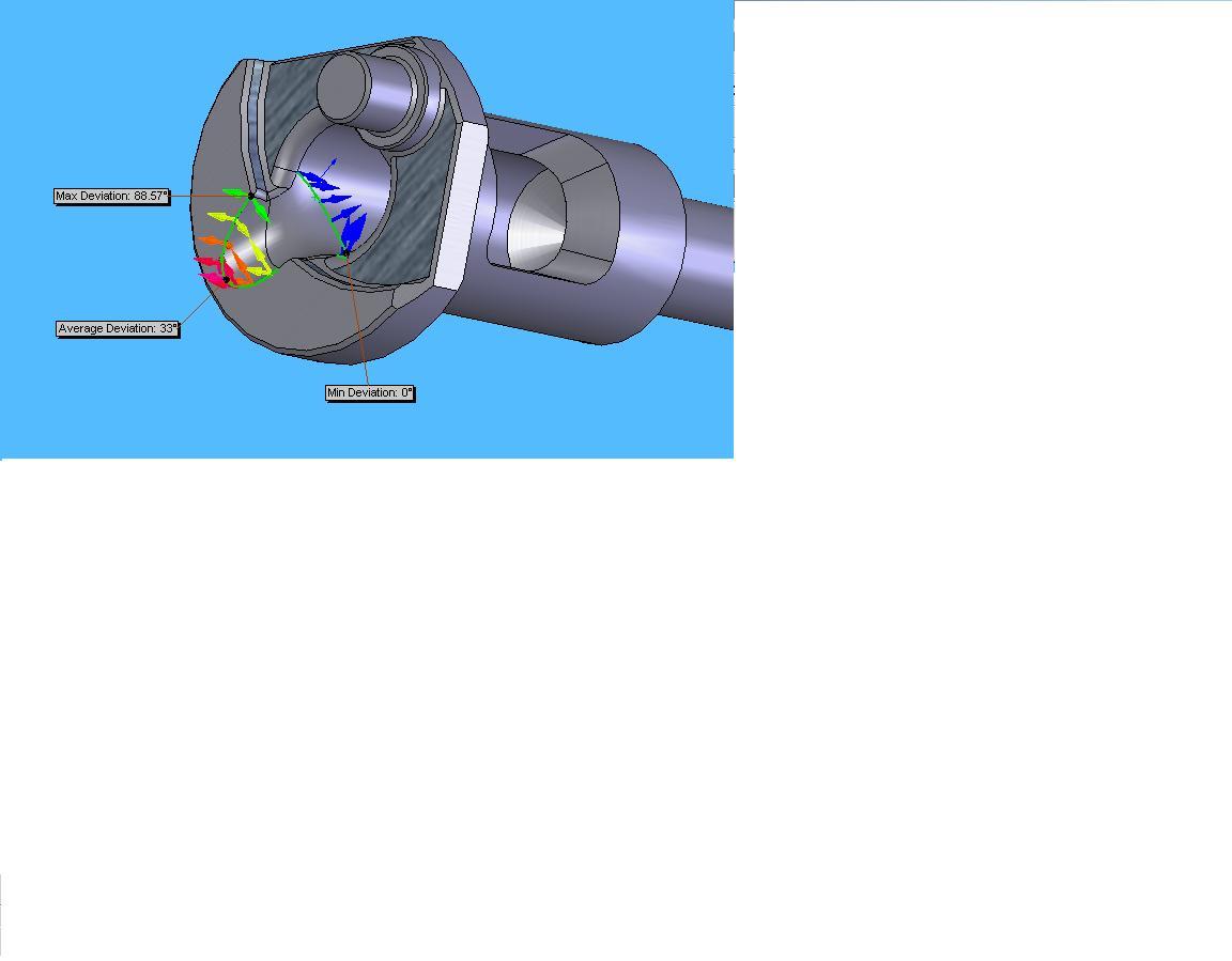

after looking at the last image show the min and max angles, how would you go about measureing those?
It will be tough to do it by hand, on the CNC it comes right from the drawing. Only can sugest mesure it by eye.

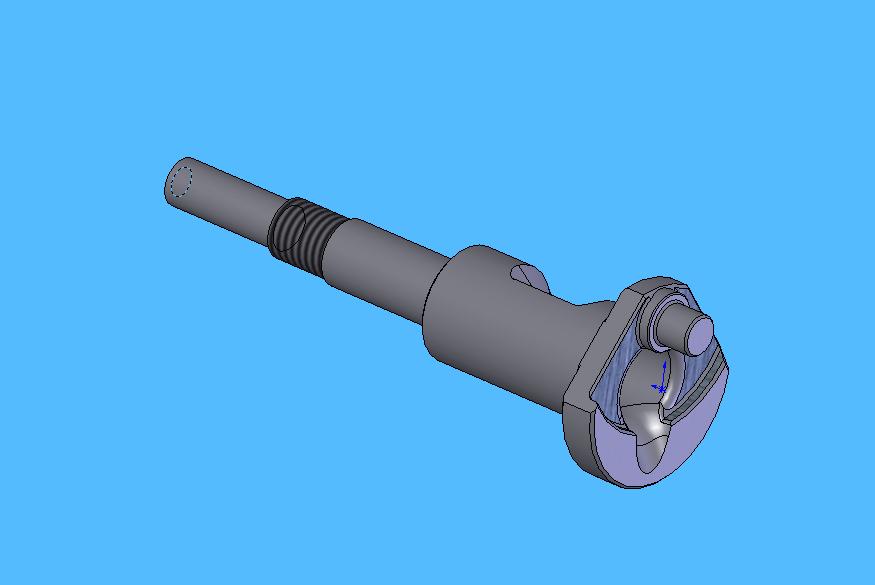

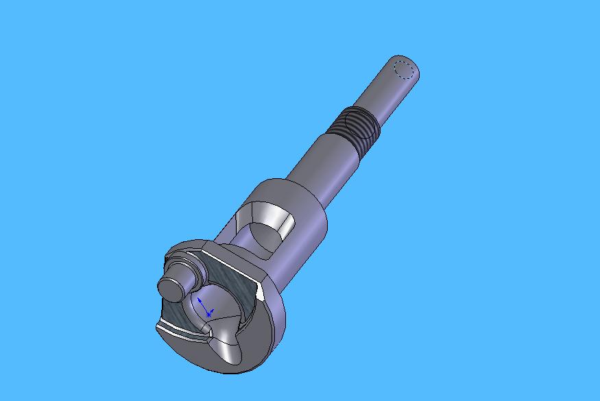

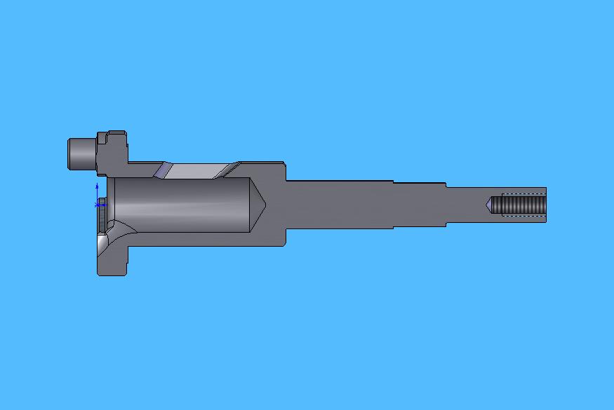

Here some more pics for modding.
Porting & Polishing question's-shaft12.jpg   Porting & Polishing question's-shaft12-1.jpg   Porting & Polishing question's-shaft12_2.jpg   Porting & Polishing question's-shaft12_5.jpg   Porting & Polishing question's-shaft12_6.jpg
