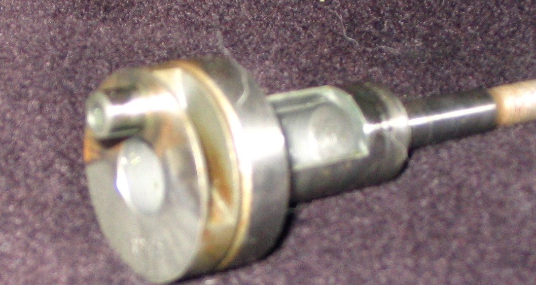

ed this is just for you, i have a COMO S .40 plane motor that i want to modify, i understand that plane motors run more for torque and not rpm. any tips on how to hop it up a little, and wow this crank sure looks a little different.
Hi Mugenb.
Not neccessarely planes motors are torque and not RPM. It is depend of aplication-for airbatic you realy want to torq and you don't want to engine start winding up, for Pilon racing-they want to have winding engine.
Please send me pics of our crank and sleeve, I might be able to suggest something by looking on the pics. You can post them here as well, I hope nobody will be affended by those pics . I am not familiar with COMO S 40 motor, will look on the net, may be can find some info on them. But pics defenetly will be helpfull.

SORRY I'M not to good at posting pics yet. this is a itailan motor i don't know if thunder tiger is a itialan company. it is side exausti it has one boost port and two fuel ports and the exaust port. it is a old wore out motor but the guy just gave it to me and said here you can have it show me what kind if work you can do. i told him i do car motors but have never done a plane motor. he just wanted to see how steady of a hand i have. he has some customers that want some mod work done to their car motors. but i would like to mod this and make it run again to see how the mods work, he sells alot of planes out of his hobby shop. thanks for the info in advance. MUGENB46
