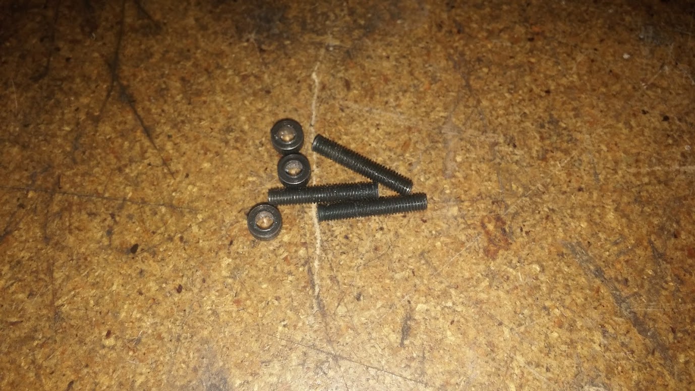

I've hit a snag...the head bolts on my OS are rounded...I can only get one of the four bolts out...it's a 2.5mm Allen key. Any ideas on what I can do?
I was thinking that I can heat up the engine with a hairdryer and also file down a 3mm Allen until it is a snug fit?
Also, should I use oil of some sort on the head bolt threads (once I eventually get them out) when I reinstall the bolts? The one that came out felt like it was binding and was very tight.

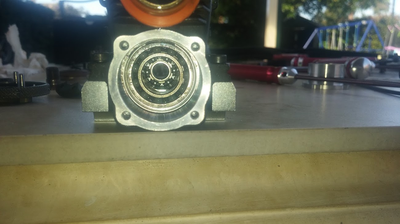

check this out - the pics are of my IDM Ielasi engine...had this crap in it which discoloured the residue oil like a brown rusty colour & thankfully the oil was silky smooth - had a bit of surface rust on the end of the crankshaft BUT that easily came off with a simple wipe.
why did this happen & how can i prevent it from happening again? FYI, im using Maxima fuel which i run dry when im done, then i'll run the podified after run fuel (only a cap full) & run that dry.
very odd as my OS engine is like new internally...

I used a 3mm drill bit & on a slow setting i carefully drilled out the caps (i added wd40 so that i didnt burn out the drill tip) - very easy & you know once the cap came off as you can hear the pop sound
very happy!!!
It is not always rust. If there is a large amount of castor oil in the fuel then it can be some dryed up castor. That almost looks te same as rust.
But yes, rust is possible. The combination of wrong oil (mostly only synthetic), nitro and some moisture in the air or in the fuel can cause rust very easilly,
