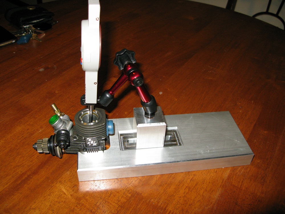

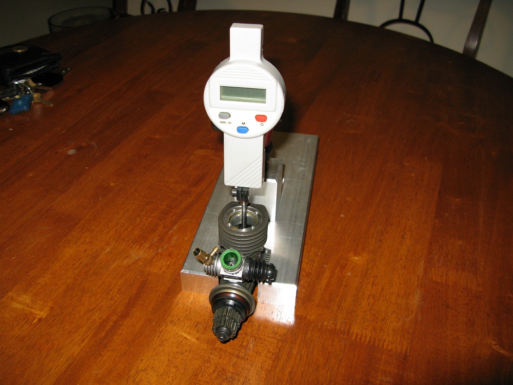

This is the setup i use, I find it extremly accurate, i do find that the key to accuracy is using a dull light.
