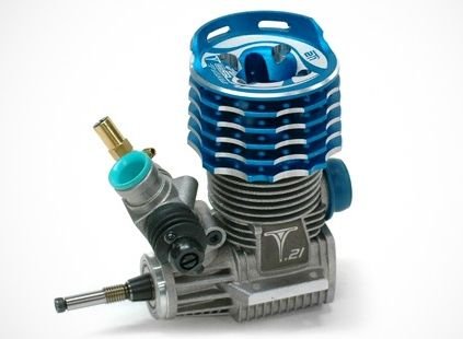

1/8 IC Fan 09-25-2020 05:09 AM
Touchè I was thinking of Tesla, their old brand...
https://cimg8.ibsrv.net/gimg/www.rct...c78d03bec6.jpg

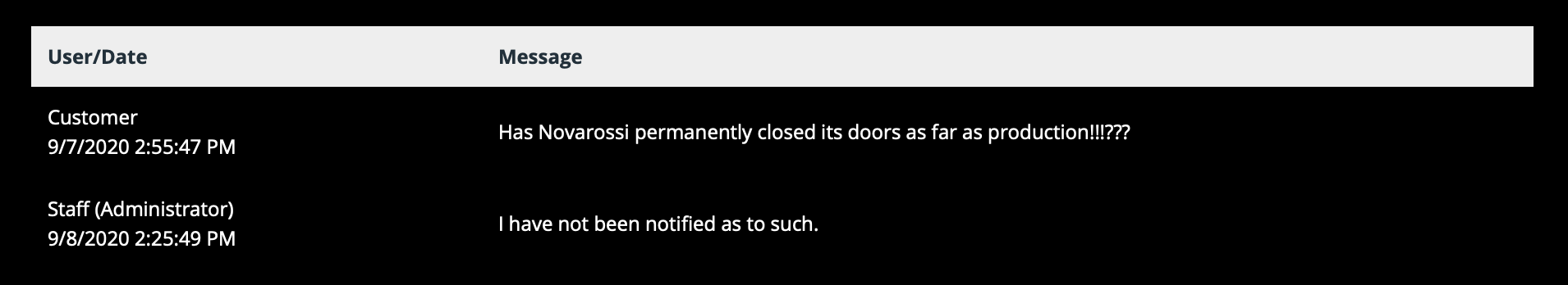

petersen114 09-25-2020 10:05 AM
Originally Posted by nitrodude (Post 15693996)
I placed an order with Novarossi Direct, the USA distributor, a few weeks ago and my order was, inexplicably, canceled. My guess is the factory has shut down for good, or is about to. Shame really. I'm not longer using Nova motors, and haven't for a couple of years, but their exhaust springs and gaskets were the best ones I've ever used.
I actually messaged them through their site and asked if Nova was permanently closed its doors. Did you get a explanation for the order cancelation?
https://cimg8.ibsrv.net/gimg/www.rct...33dc9c5cc1.png
