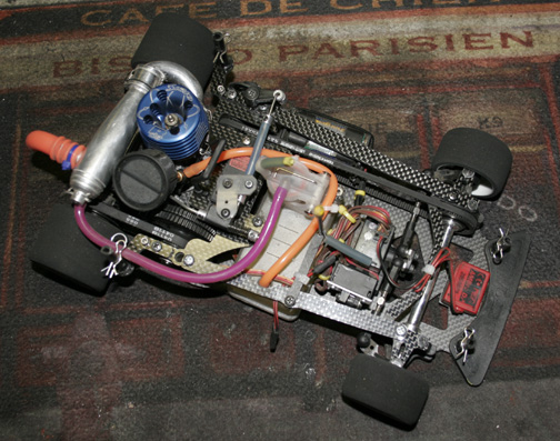

By the way.. this my car:
http://www.rctech.net/forum/attachme...6&d=1196910549

I see your running the full lower carbon chassis. Is the the Rony, Honest, or Kyosho chassis? If Rony or Honest full carbon, do you have the Charge aluminum heat sink mount? I noticed Kyosho opted to keep the rear engine section aluminum. How did the pipeset feel compared to stock plastic exhaust. I hope the Kyosho black angled pipeset works better.
My next changes are the Kyosho are carbon chassis, rear deck and rear brace. I also like the Charge rear axle shaft with thrust bearings.

Zoot, I also noticed you installed a rubber tube to the rear pipe outlet. Did you notice an change in tune. I know that the rubber tube can affect the pipe tuning.
