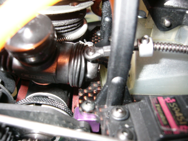

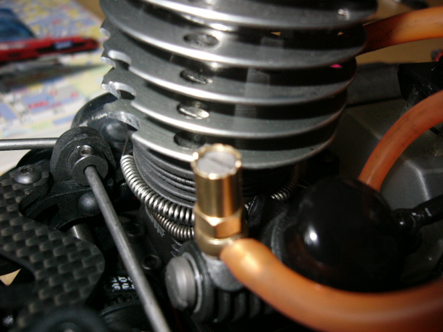

I just bought this Orion wasp .12 crf engine last week brand new and broke it in friday and after about 4 to 5 tanks I noticed a bad wet spot on the lower part of the carb area above the flywheel then saturday I race at our local track and that is when I notice the whole lower engine was wet and all around the flywheel area along everywhere else in that area. I called Team Orion tuesday and was told they have no issues with front bearings and I would have to buy a new or send the engine for them to see, I really dont wanna send the engine when I could install it my self, and be out a engine for a week or so..

The pics didn't show clearly your needle settings ... but apparently you might be running a bit too agressive on slow speed needle setting with which you might need to set the high speed needle on the rich side in order to keep the engine running within a "safe" temperature range.
Suggest you to reset your needle settings (I set the slow speed needle of my CRF engines much richer than yours ... I could see the slow speed needle set screw of my CRF engine from the bird view; I am very agreesive on the high speed needle setting though).
If the leaking problem persists after you reset the needles, Team Orion should get you a replacement front bearing or other parts which caused the leak ...

I dont have a problem with the engine idleing and the engine runs at a very good temperature very over 230 and thats using exergen, its just leaking eal bad and very hard to start when cooled off, here are the needle settings tell me what you think;

This is my needle settings for your reference. The fuel I used was Odonnel 30% & the head shim of my engine was 0.4 mm.

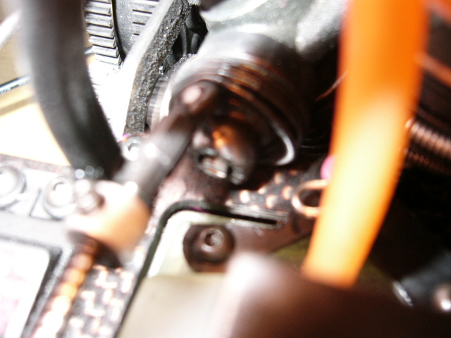

Well today I cleaned the engine real good and put after run oil in there and let it sit, I came back thirty min later and the after run oil was already leaking through the rubber seal, thank god it was not leaking at the crankshaft, here are some pics but they are not that close but you should get the picture, what should I now with Orion..

from the new picture, it seem you have worned out seal around the inner race bearing. its possible it's cause by the tapper cone washer, put a shim between the bearing and the tapper cone washer next time to prevent premature wear/tear on the sheild.

how can you tell that, it looks like a wet spot around the inner race bearing and i used the cone it came with, sounds odd for a brand new engine with less than 15 tanks of fuel threw it, but it cool its just a bearing I will change it space it and see what happens, and does the carb update make a big difference

The after-run oil came out from the front bearing is normal if you put too much in. Since CRF have different design on crankshaft....... oil leaking may be happened more than other brands even you put same amount after-run oil to these different engines.
Every first time before you start a engine, you should take out the glow plug and bump the engine on start box and force all after-run oil out. Then you won't have oil leaking problem all along the whole day.
Actually a little bit of oil come out from front bearing is normal......... of course you may need a new bearing if too much oil leaking.
