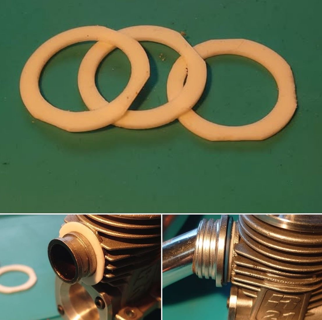

Probably based on the R2106 which its crankshaft has a much larger timing than all previous models.
The shims are no sleeve shims but exhaust shims to lengthen up the exhaust a tiny bit for a little bit more bottom torque w/o the need for a different manifold. Funny thing is that a year ago I placed this on my FB page, just quick and dirty made for a test and nu I saw this Shimo model. Makes you wonder where he got his idea from....

Roelof Placing shims there, alters the manifold lenght... but differences of half and one millimiter makes me wonder... ¿found enough difference between them or was just splitting hairs?

Remember the Novarossi 5/6/7 fin manifolds? Those fins are just about 2.5~3mm separated and you could feel a huge difference between them. I made them from 1mm teflon and can stack up 2 of them behind the rubber seal. On the exhaust side the dimensions are different but if I make them for there too I could go up to 4mm extra length, that for sure will be a lot to notice.
But I believe the MR05 manifold that is in the combo package is a short one so I believe with these shims something will be noticeable. And as the tekst says, it is a finetune.

Yep, but I have not seen any list of the length or what kind of performance is linked to those manifolds. Also the topicstart talks about a combo package, you can buy a 50 dollar manifold not knowing what to get or you can get a few dollar shims with which you know you get some better low rpm performance.
