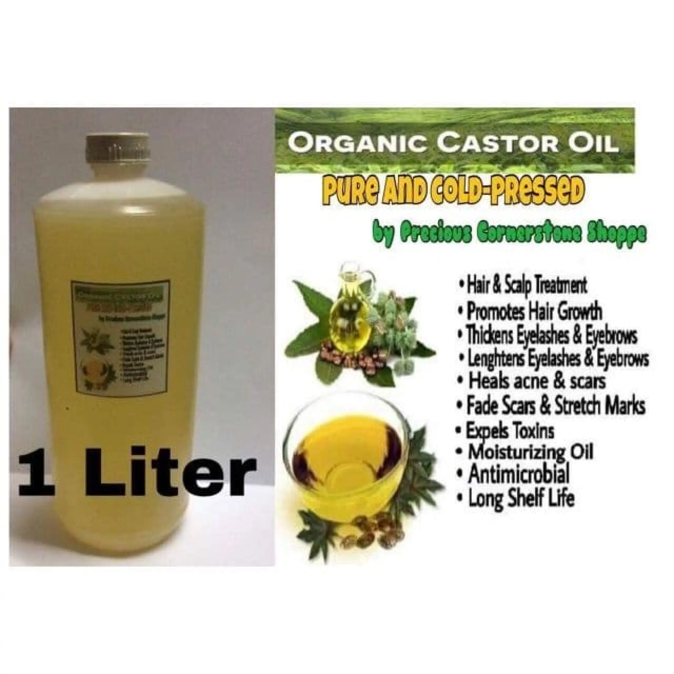

Originally Posted by silence360 View Post
Castor oil, as in vegetable oil? Also your pinch meter, is that the amps of the motor that you are monitoring that I think I read you stated would reduce as pinch is reduced.
Castor oil isn't vegetable oil. It does come from a plant, but it's not digestible. This is important because the properties that make it not digestible also make it a much better engine lubricant than vegetable oil. Using vegetable oil from the grocery store won't work, partly because its smoke point is too low for use inside a combustion engine, and partly because it doesn't dissolve in alcohol, which is necessary for proper oil delivery in an alcohol-powered engine.
Castor oil from the pharmacy (sold as a laxative, again because it's not digestible) works fine, though. I've been adding a small amount (about a shot-glass-full per gallon) to my nitro to raise its oil from 11% to 12% for years.
fyrstormer is offline
Old 12-16-2021, 05:50 AM
  #26
Join Date: Apr 2007
Location: Overseas
Posts: 582
This is what is available in my country.

Just go to a kart shop or a dirtbike shop and get some race grade castor oil.

Cool, cause that is all that I've got access to here.
