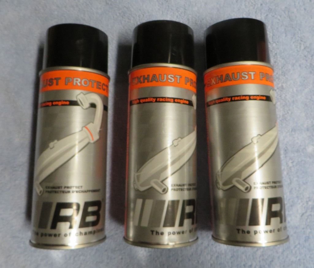

All cans are SOLD !!

I also use the crock pot method with antifreeze. $ 15.00 for the crock pot at Wal-Mart. I put it on high and let is sit over night on the patio. Fish them out with needle nose pliers, wash them off inside and out and then polish them with Mothers Aluminum mag wheel polish. Look like new again. When I get to the track, I put this on and keeps the pipe real clean. I tried the RB spray can and threw them away. Very messy and did not work to good.
