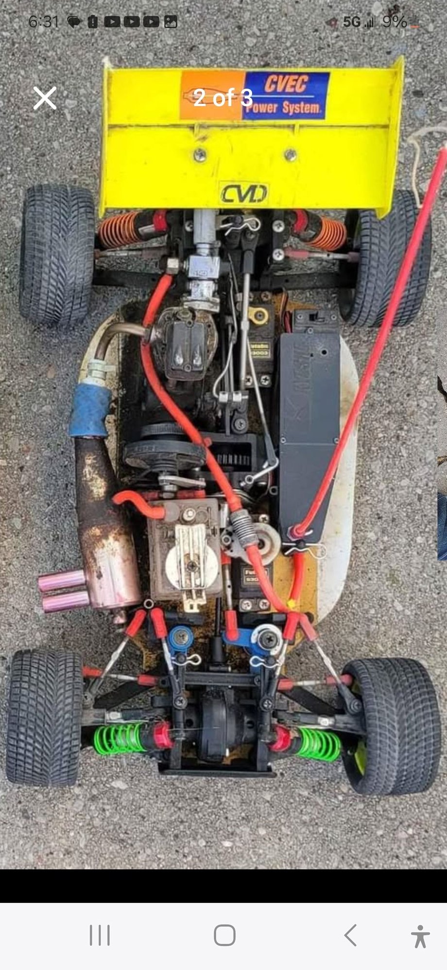

Default Os 26
Saw this for sales Wisconsin. Legend status obtained. Says os 26.
jasburrito is offline
Old 03-26-2025 | 03:32 AM
  #2208
petersen114's Avatar
Joined: Jul 2007
Posts: 4,400
Looks like someone had a lot of spare parts across different brands lol. The engine is probably a OS FS SC. There are a couple threads on here somewhere of folks adapting them to work in cars.
