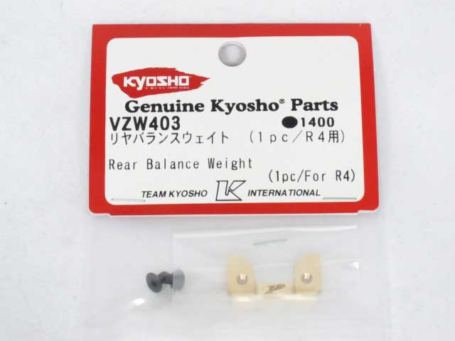

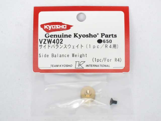

R4 new parts
Attached Thumbnails Kyosho v-one r4!!!!-ky-vzw402.jpg   Kyosho v-one r4!!!!-ky-vzw403.jpg

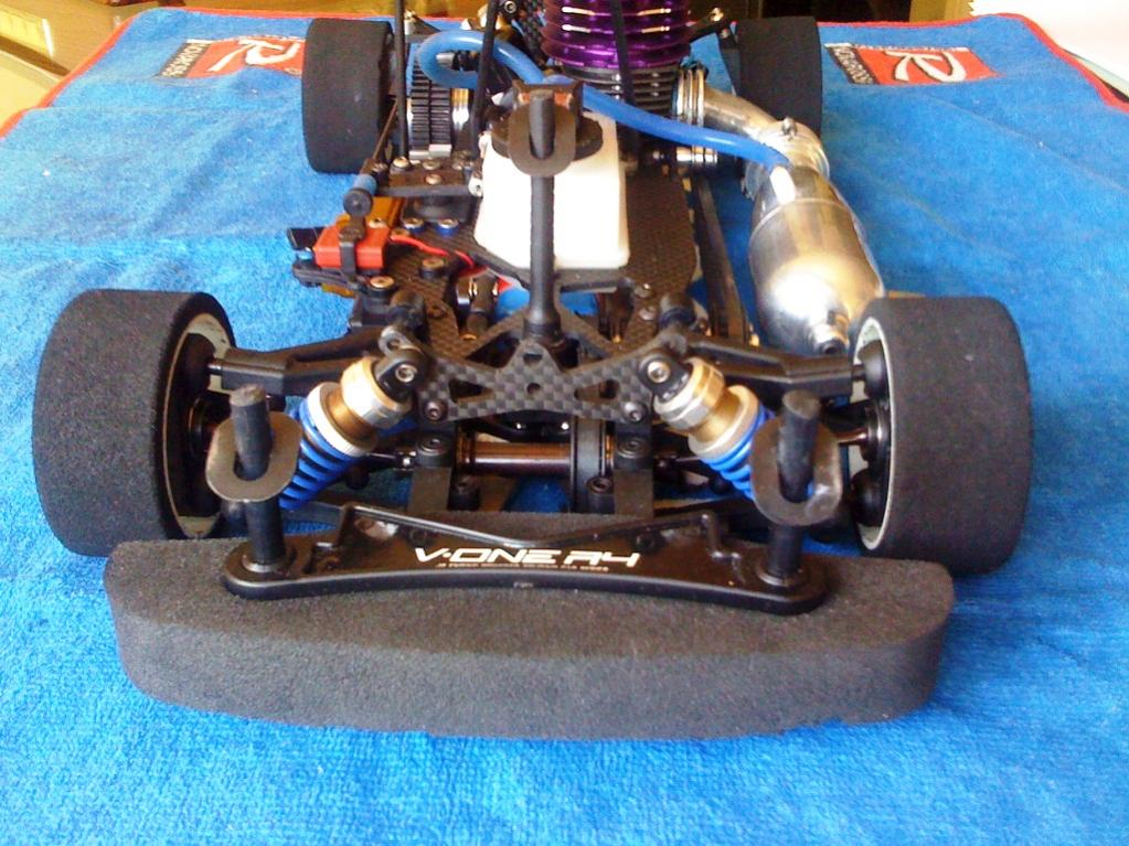

Sorry for my late answer but I was sleeping: in Italy now is quite nine in the morning.
This is my R4 with the spool adapted from Hudy spare. We are still waiting the spool from Kyosho.
Yes the 50.000 on R4 is like the 20.000 on RRR.
Another modification I've done was the rear offset to be able to use my kyosho tires with -2 offset.
If you like I will show you how.
Sorry for my english.

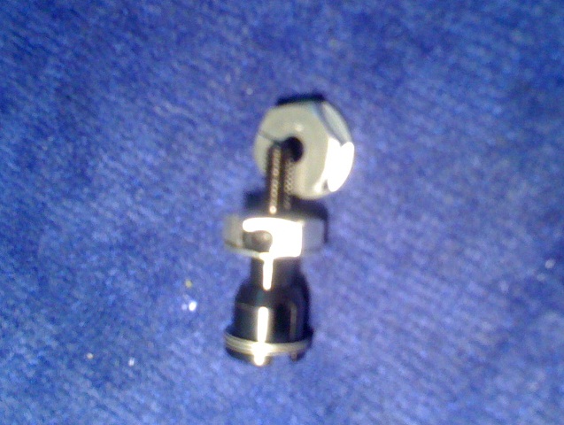

if you could please show how you run offset thanks

I have lowered the wheel hub by 0.8 mm from the internal side and inserted some washers from the other side ... I will post the photos as soon as I will take back my photocamera from a friend of mine.
That's the photo that i can make at this moment ... sorry

bro, can u post pic for ur wiring seem like u wiring so nice t.q
