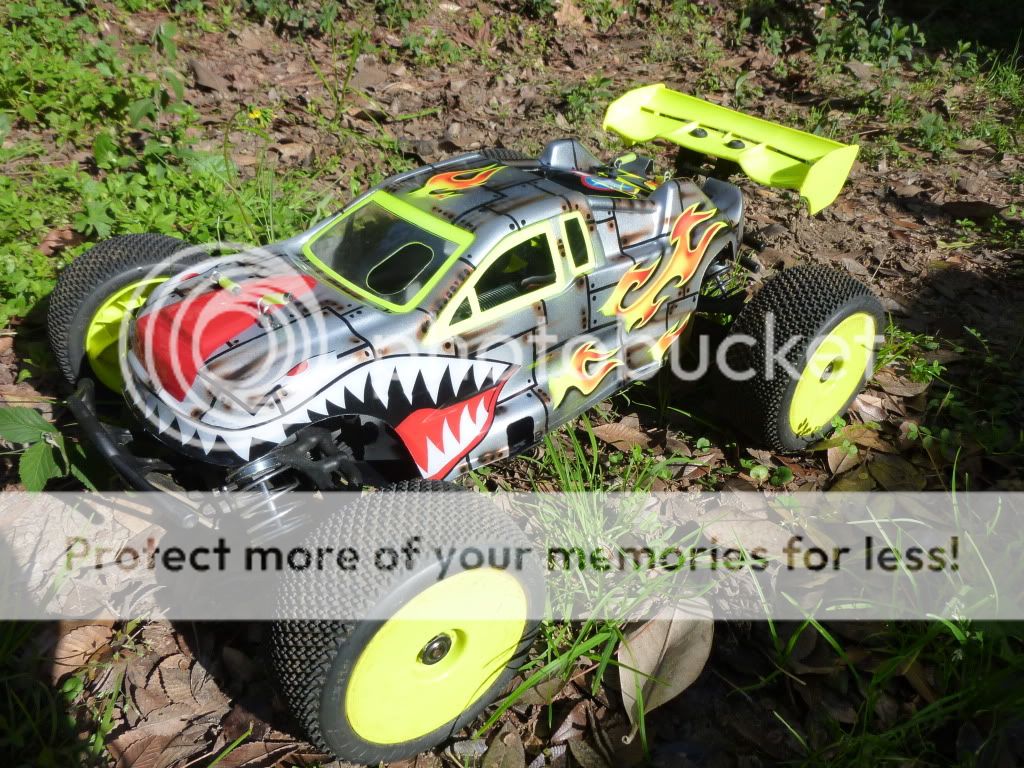

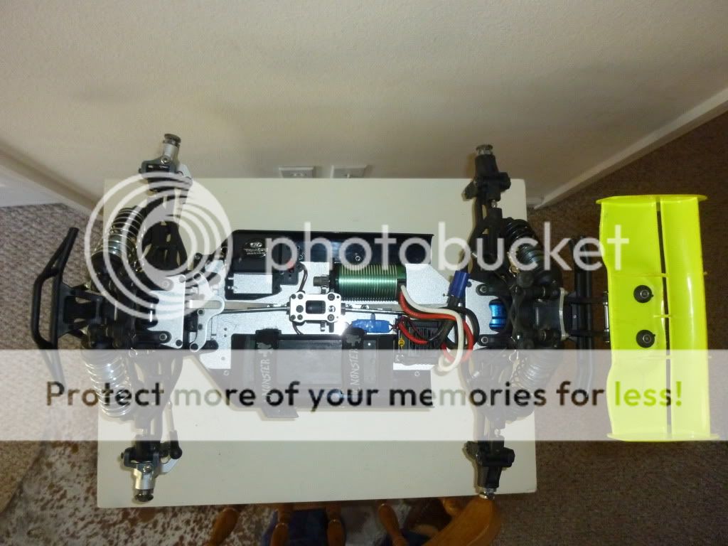

My setup is:
Engine: CC 1515 2200KV
Batteries: Gens Ace 5000Mah 4S 14.8V 40C
Engine mount: RC Monster Electric Motor Mount
Diffs (stock or LST): LST2/XXL Diff 3.307
Ring Gear LOSB 3534 which is 43T
Pinion Gear LOSB 3534 which is 13T
HD cups, HD outdrives, and HPI hardened diff pins.
Diff fluid (Front/center/rear): 7K/10K/3K
Gearing (pinion/spur): 46T Spur/ 12T Pinion
Shock oil front = 30W
Shock oil rear = 32.5W
Shock springs Front = Silver
Shock springs Rear = Black
Shock position on front a-arm's = Outer
Shock position on rear a-arms = Outer
Sway bar = None in Front, Thick in Rear
Front toe = Slightly toed-out (set by eye)
Tires (brand/size/offset): Proline VTR Caliber, 0 offset
Camber with RPM a arms: Rear 0, Front -2 degrees
Battery Tray: 10 SCTE
Reciever Box/servo tray: 8ight-E
Steering servo: Hitec 7950TH
Additional Mods: 15 Degree Caster front C-Hubs, with bumpsteer correction. Aluminum front spindles. Lunsford titanium turnbuckles on all a-arms, and steering. Rear shock flip with DPP wing mount bracket. Mugen MBX5 wing kit with OFNA High downforce wing.

Nice shem, Thanks for the info. Very nice truck. You must race that beast?
Thanks bud! Yep my club is Tallahasse RC. They have an awesome group of guys there and the track is very fun for 1/8 Truggy.
