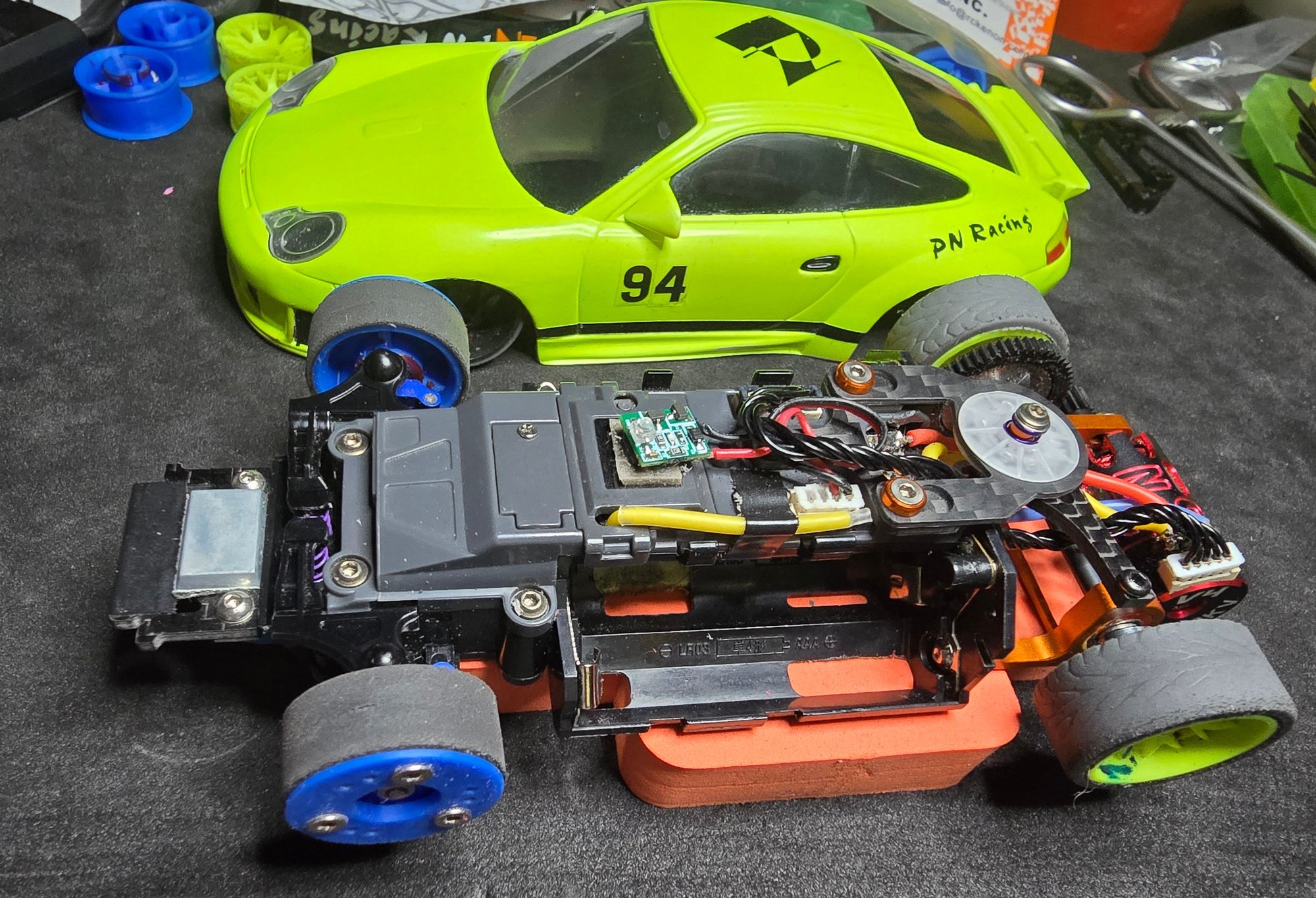

I'm starting my of month timed runs, and I am beginning with my SWB cars first. I've been driving them the last few days and I'm used to their needed steering inputs to try to keep them on their wheels! I finally got my Porsche 911 GT3 RSR body to drive pretty well on my MX-5 chassis, since I made the porsche chassis into a 98mm brushed chassis. I was able to stay with PN KS1138 front tires on 19mm 0mm Disk wheels for both bodies, and just change the rear wheels to a 20mm 0mm PN BBS yellow with KSM Soft Radials worn to slicks from a 20mm -1mm DXR Carbon wheel with KSM- LH Soft slicks for the MX-5.
It wasn't my best time with 1 roll and a few stops from cutting the corners too close, but OK for 90mm on this layout! Track temp is 73* at 54% humidity. We're in our normal Texas summer time pattern with 100*+ days with little rain till October, so hopefully my cars will settle a bit.
Class- PORSCHE
Date- 07/30/2025
Location- Central Texas
Race Time- 347.029 / 5:47.029
Fastest Lap- 4.179
Chassis- MR04EVO
Body- Porsche 911 GT3 RSR
Wheelbase- 90mm
Tires-F- PN KS Medium LH (new KS1138) / R-PN KSM Soft Radials (worn to slicks almost)
Wheels- F-PN N 0mm 19mm Blue 3D Disk wheels / R-PN W 0mm 20mm Yellow BBS
Motor-PN Anima V4 3500Kv Sensored
Batteries- Eneloop 850
Front Springs- PN Purple
T-Plate-PN #3 Black Carbon Fiber
Motor Mount-Nexx 90/94mm RM
Dampener (If applicable)- PN DDS (Purple top disk/Purple bottom spring)
Gearing-13/53 PN Gear Diff
Notes- Car was pretty good, but it needs more tweaking when going from MX-5 to 911 setup! Speed going into the 180s was my problem. Too fast and I'd TR, too slow and I'd hit the inside wall and stop me.

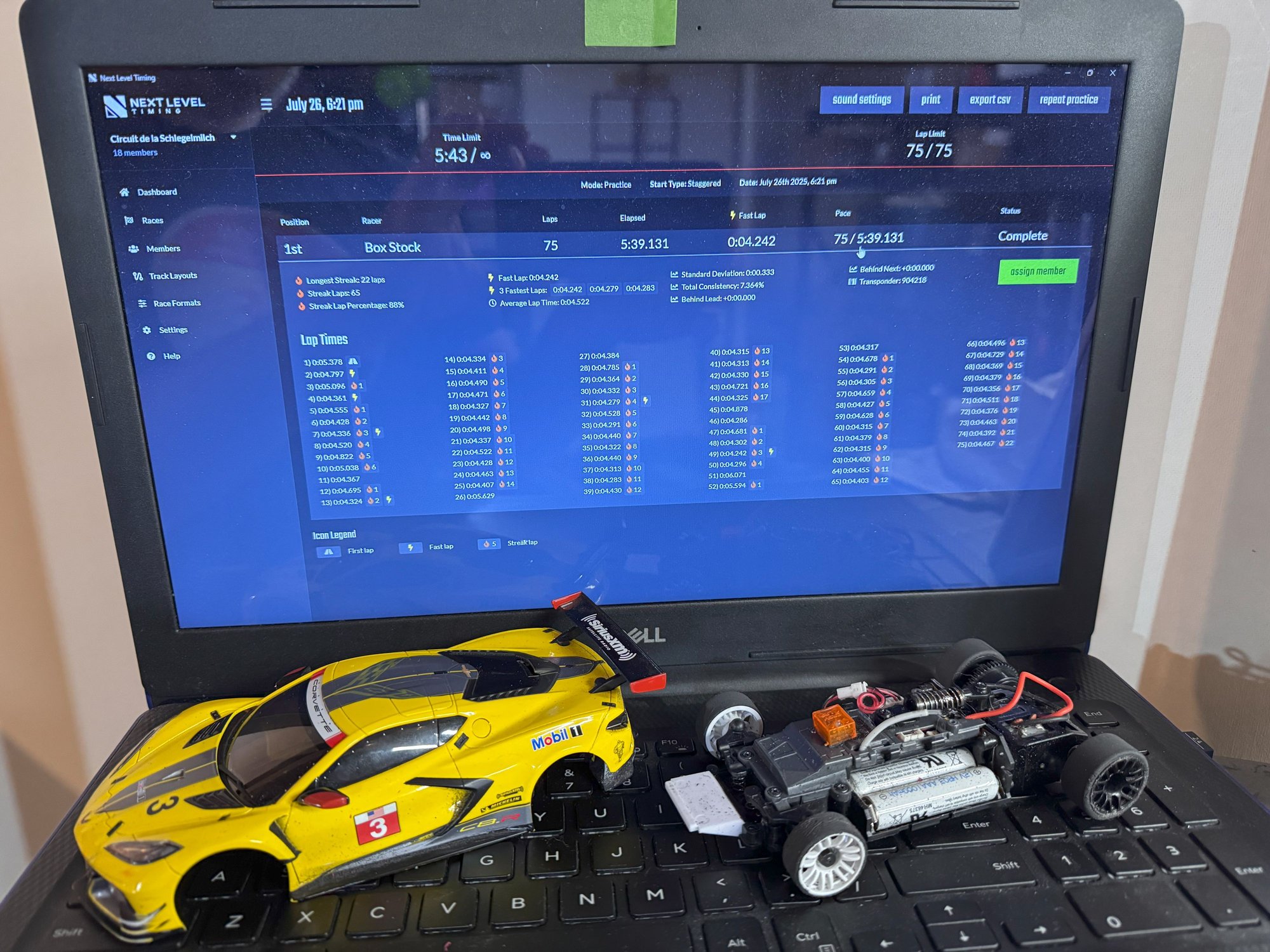

Class- Box Stock
Date- 7-26-25
Location-Omaha, NE
Race Time- 5:39.131
Fastest Lap- 4.242
Chassis- MR04
Body- C8.R
Wheelbase- 98MM
Tires- Kyosho 30 low height front(might have been 20?) Marka V1 10 Slick rear +2/+3 offsets
Motor- Stock
Batteries- Powerowl
Front Springs- Stock
T-Plate- Kyosho FRP 6M
Motor Mount- MM
Dampener (If applicable)- Stock
Gearing- 7T
Notes- Shoe Goo is holding the front end together quite nicely! Had some steering glitches, might need a new servo saver, keep knocking into the inside turns. Had some really fast laps in other runs but this was the most consistent and lowest overall.

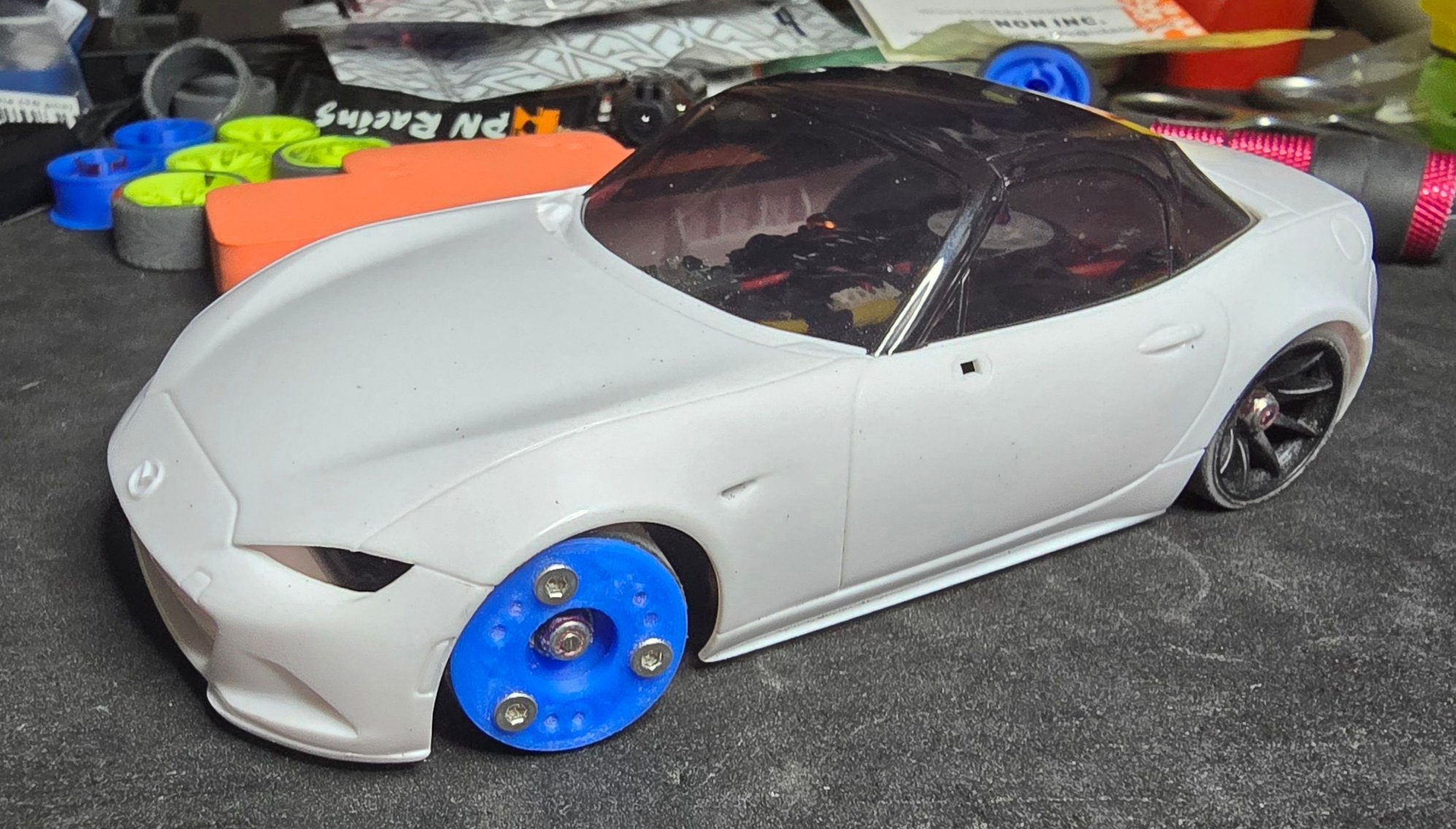

Class- MX-5
Date- 07/31/2025
Race Time- 342.652 / 5:42.652
Fastest Lap- 4.198
Chassis- MR04EVO
Body- Kyosho MX-5
Wheelbase- 90mm
Tires-F- PN KS Medium LH (new KS1138) / R-PN KSM Soft LH Slicks
Wheels- F-PN N 0mm 19mm Blue 3D Disk wheels / R- DXR W 20mm -1mm Black Carbon
Notes- Car was pretty good, but me not so much! Speed going into the 180s was my problem. Too fast and I'd TR, too slow and I'd hit the inside wall and stop me. I had 1 roll and 3 mistakes that required reverse this run, but it was good for how I'm feeling!
