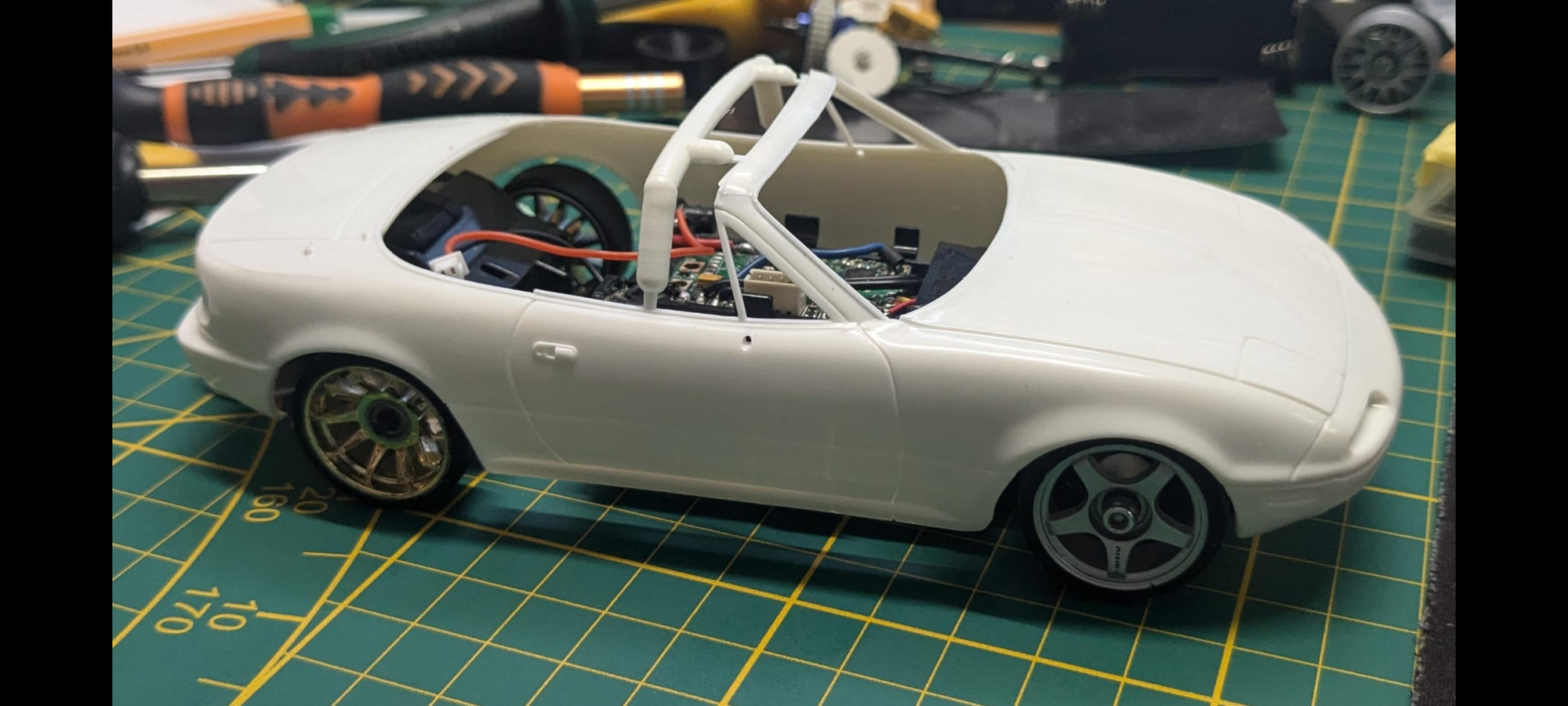

Since we're discussing narrow bodies: is there a ruleset for the "unofficial experimental MX-5" class? Or is it - as the name suggests - a class to experiment with setups until I find one I like?

The "Unofficial Experimental MX-5 Class" was thrown together since a few of us had MX-5 bodies and thought it would be cool to run a 90mm class that was could run the wide rears that fit the MX-5 body and not just the Narrow rears for the Narrow Class. It's an Open class, so anything that will fit under a MX-5 body is cool. I'm not familiar with what body that is, but it looks good! What is it? It has the look of the windshield I was wanting to do with the MX-5 windshield and add a roll bar to make it look like an actual MX-5 race car. I made a roll bar out of a PN Lexan rear body mount, but it's VERY HARD to get the body on, so I just gave up on it. A 3d printer would work great, but the wife hasn't gone for one ,, yet!

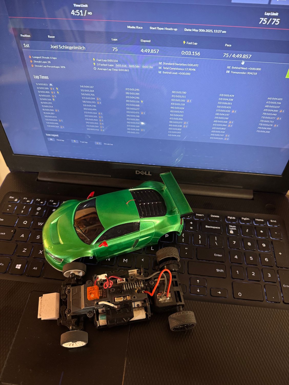

Class- Box Stock
Date- 5-30-25
Location- Nebraska, USA
Race Time- 4:49.857
Fastest Lap- 3.156
Chassis- MR04
Body- R8LMS
Wheelbase- 98mm
Tires- Kyosho 30 front 20 radial rear
Motor- Stock
Batteries- Kyosho
Front Springs- Stock
T-Plate- Kyosho 5M
Motor Mount- MM
Dampener (If applicable)- Stock
Gearing- 7t
Notes- Didn’t blink

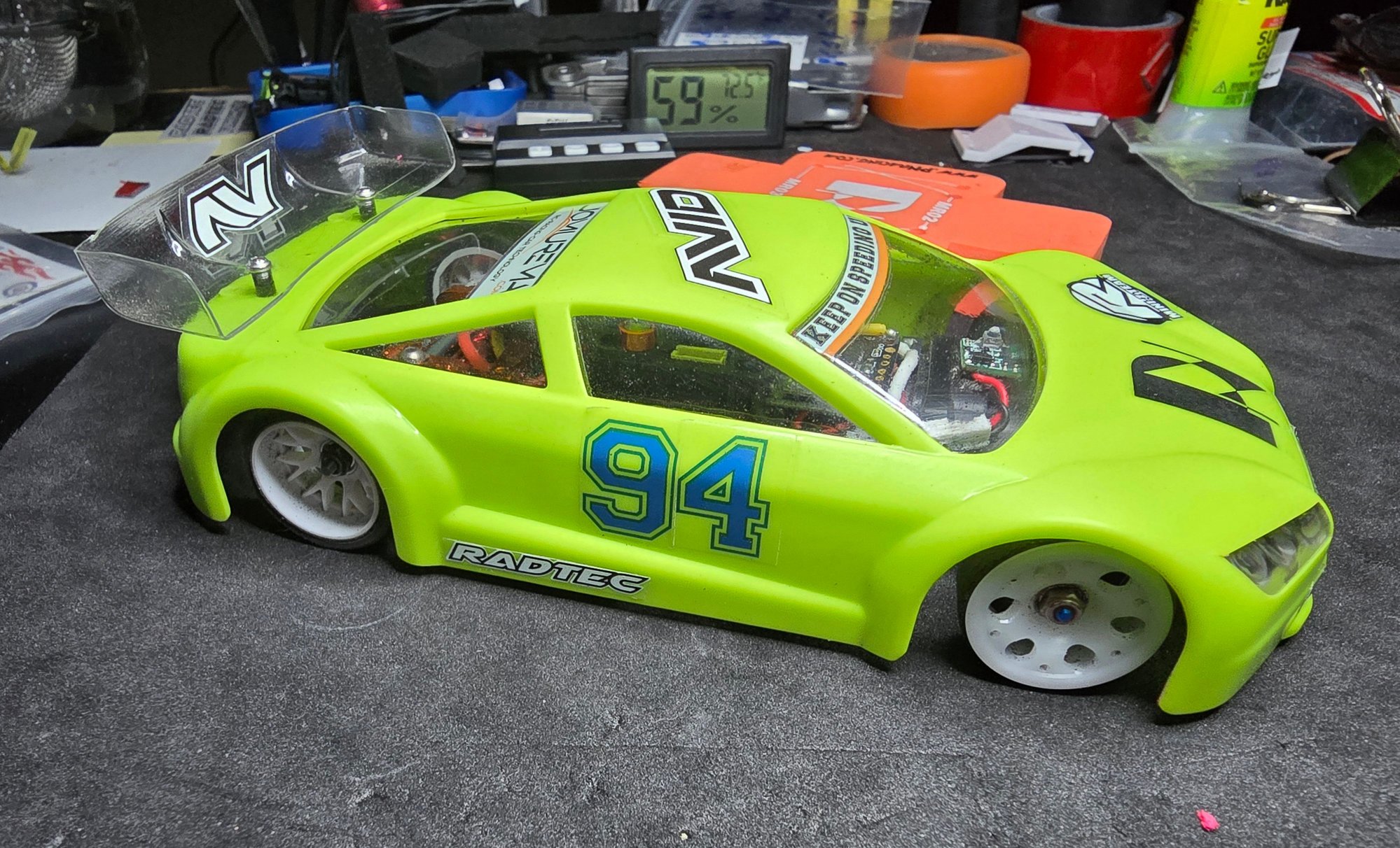

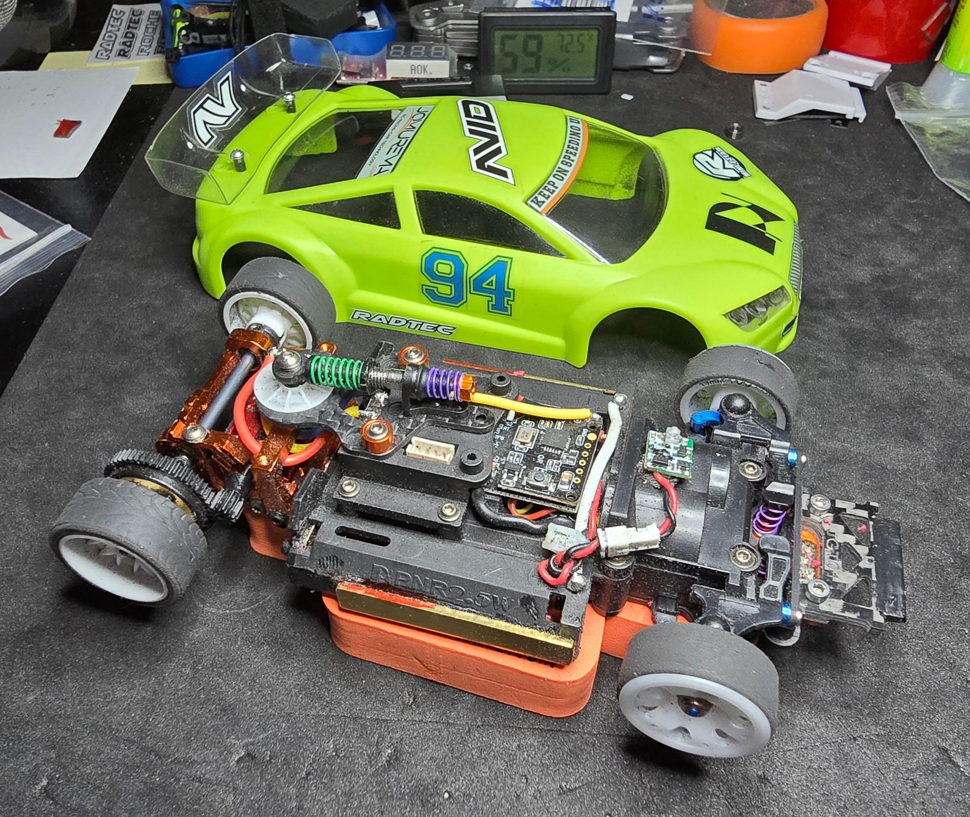

Class- STOCK
Date- 05/31/2025
Location-Central Texas
Race Time- 268.538 / 4:28.538
Fastest Lap- 3.191
Chassis- PN 2.5W/MR03EVO board/ 04 arms/ Reflex 1* Alum Knucks
Body-Jomurema
Wheelbase-98mm
Tires-F-PN KS Soft (I think) / R- PN KS Soft radials almost slicks
Wheels- F-PN N+ 0.5mm 19mm Flanged White 6 hole / R- PN W+2mm 20mm White BBS
Motor-PN 3500Kv
Batteries- Eneloop 850HV
Front Springs-PN Purple
T-Plate-PN #3 Silver Carbon Fiber
Motor Mount-PN V3 94/98mm
Dampener (If applicable)- PN DDS ( Green top/ PN lt. purple X-Strenght bottom spring) PN Dual Spring Top Shock (Green Front/Purple Rear)
Gearing-12/53 PN Ball Diff
Notes- Car was running ok, but it needed more work. I spent most of the month working on my GLR and Pro Stock chassis, and it showed with both Stock and Box Stock! Track level humidity is at 65% at floor level @ 71.6*
