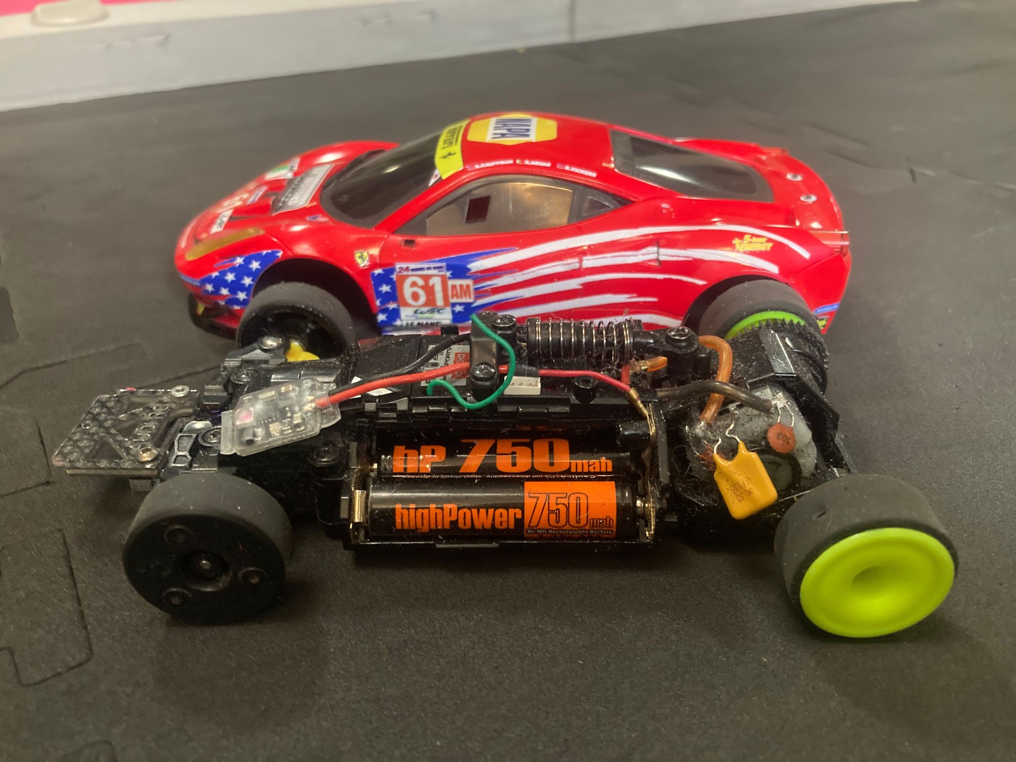

Going to the Nexx RM pod stopped a lot of the on power rear wheel hop, but I still have more than I like! If I'm super easy on throttle it doesn't do it, but I'm slow! To have any speed it hop city.
So my question is: Is the wheel hop just something you have to live with when on narrow rear wheels? It's running with a PN 70T, since it's a Ready Set board no Brushless
, so the Axel is at it's highest ride height to get track clearance and I have to run normal height tires to keep the Spur off the track, which I only have a few sets to try. I'm pretty sure I have KS-M softs on there now, and I figure it's hopping due too much traction with the amount of power. So maybe gear up with a larger pinion, I have a #5 t-plate carbon but I have #3 and #4s too, PN Dual Center shock w/ spring kit to adjust. I also have the Inner Tube Shock Set w/ springs if that will help!
Any Ideas? Thanks in advance! Drew
p.s. I will go to a EVO board asap. Hopefully a MR03 EVO, if I can find one, if not it will be an MR04, but that complicates things with the power of the MR04. Most say the 5500kv is about the same power as a stock Kyo motor, but Porsche and Narrow rules say 3500kv /4100kv Kyo max. So will there be an MR04 allowance for larger Kv motors?
9/6 update: After running and tweaking I got the majority of the hop out. I went from a 9t to a 10t pinion (largest .5 mod I have), adjusted the damper post rearward and adjusted the dual shock. It is mainly hopping now when I put too much power down in the corners. I had +1mm N on all 4 corners, but it kept climbing the walls when I brushed the them, so I went to 0mm N fronts and that problem too was solved. And no additional traction roll is apparent with the change.
I also added 10g of weight, because it was only 150g! So I put 2.5g of tungsten putty in each battery channel, and a 2.5g stick on weight on the top of the carbon fiber front clip, and one on the t-plate mount bar of the Nexx RM pod. So, the weights will be played with to see how it changes the handling.
I am betting the rest of the hop will be gone when I'm able to get a EVO board and go Brushless and adjust the axel height down and the lighter motor, as my 911 chassis has no hop and is basically the same setup just BL. So for now I will keep doing minor tweaks, but it LOVES this track layout!
, so the Axel is at it's highest ride height to get track clearance and I have to run normal height tires to keep the Spur off the track, which I only have a few sets to try. I'm pretty sure I have KS-M softs on there now, and I figure it's hopping due too much traction with the amount of power. So maybe gear up with a larger pinion, I have a #5 t-plate carbon but I have #3 and #4s too, PN Dual Center shock w/ spring kit to adjust. I also have the Inner Tube Shock Set w/ springs if that will help!Any Ideas? Thanks in advance! Drew

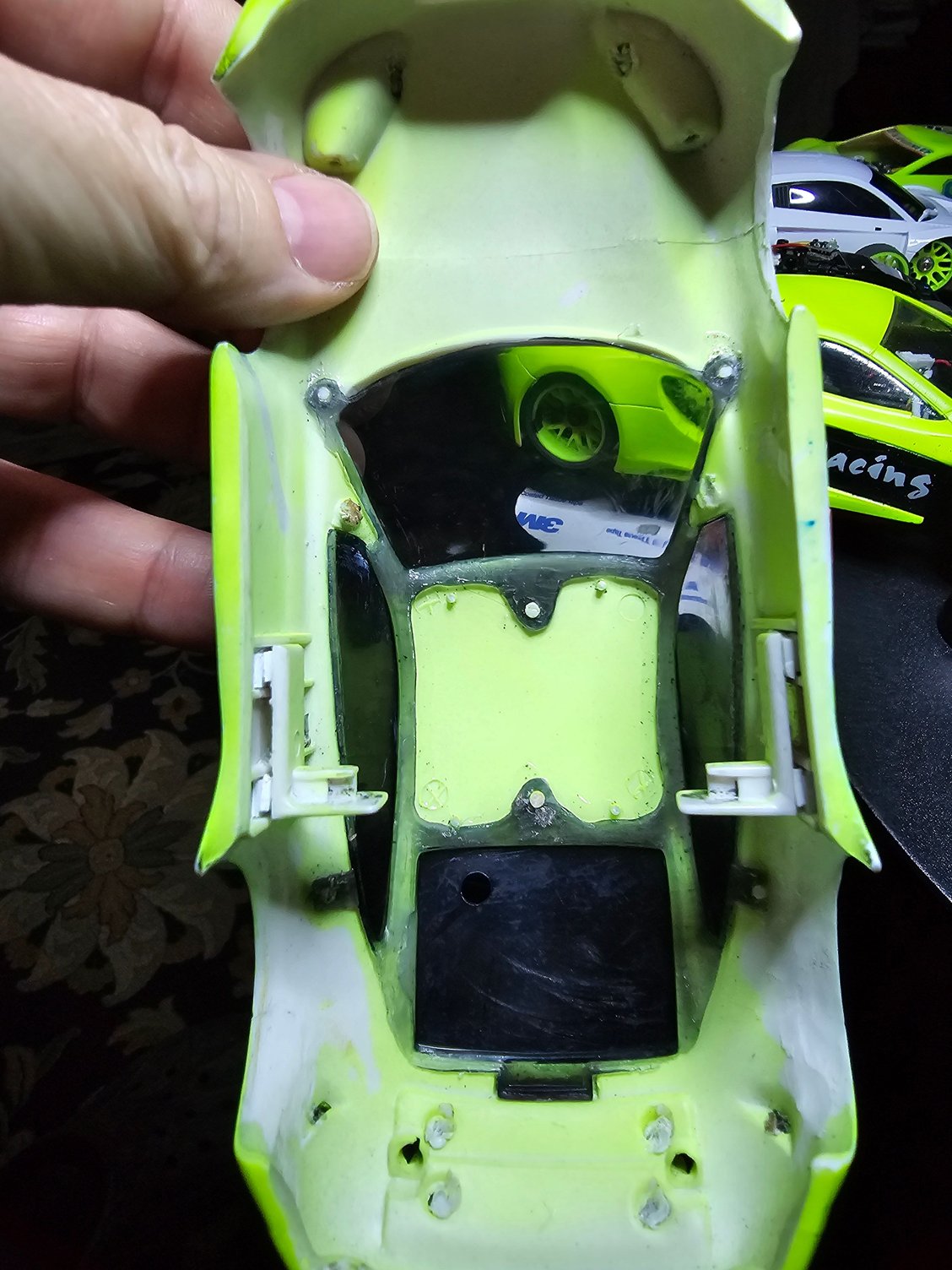

I switched the MX5 from the Kyo. Factory Gear Diff to a PN Gear Diff, so I could try running -1mm W rear wheels to see if that helped with the remaining wheel hop. I helped a bit, but it has to be the forward rake caused by the axel having to be run at max running height to get the PN 70T ground clearance. As it's the same setup as my 911 other than the motor and ride height and the 911 doesn't even hint at hop! My stock chassis now has the Kyo. Gear Diff and it runs well with the PN 3500Kv in the Multi Mount. So I guess I'll order a Kyo. MR03 chassis to replace the PN 2.5W chassis to be Narrow legal and move the ReadySet to 94/98mm Stock chassis until I get a MR03EVO or MR04EVO. I haven't found a MR03EVO board just 03EVO Chassis "roller". The only thing stopping me from buying an MR04 is the speed thing.
Anyway have fun and Drive Fast! Drew
the top isn't on the MX-5 because it is sanded, prepped, and masked awaiting paint, but it just a few grams. To those with 3D printers, how hard would it be to print out a "roll cage" to make our MX-5s look like this?
clip of pic from Motor Trend.
I thought it could possibly attach to the forward top plate damper screw holes, then you could Dremel the top off leaving the windshield. Make since? Hard to put into words what I see in my head. I'll try to draw it out in Paint and I'll post it. Anyway I'm rambelin on at 04:20!
Just a very rough drawing with my Mad Paint skills!
I would add cross mount braces to make it look real. just a thought to make the MX-5 look like a real race car! Anyway just a thought.

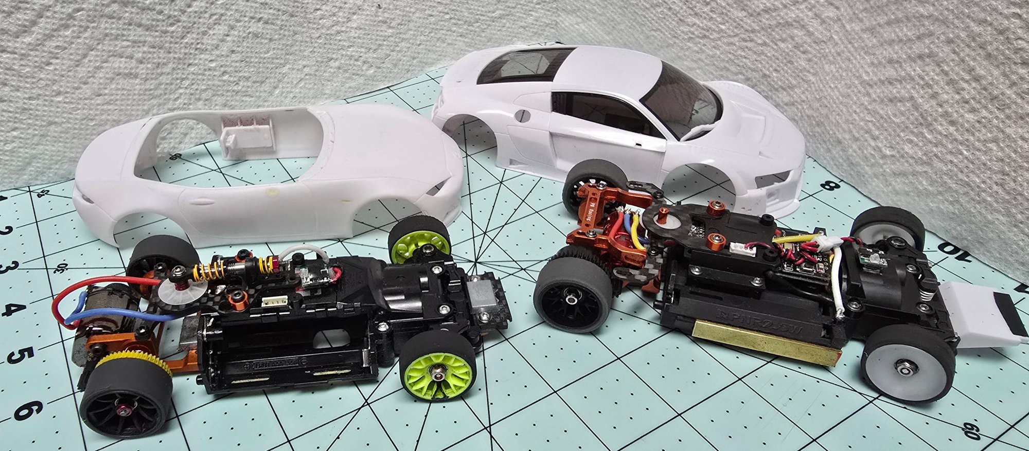

Well hopping problem solved! I ordered a new Kyo. MR03 chassis, so I swapped out the EVO from the Stock PN chassis into my BoxStock chassis allowing me to go Brushless and drop the axle and Narrow class legal . It is now hop free, fast, and smooth! Also no need for a top shock either.
So for now I will build up my Stock chassis with my ReadySet board with a PN 70T in either a Multi Mount or 94/98mm V3 pod, a PN Ball Diff, when my parts come in next week to complete it. I just enjoy BoxStock the least out of the Classes we run and I have chassis for. I'll go back to BoxStock someday after I get another MR03/04 EVO. For now I'm waiting on parts and I NEED to get busy painting bodies!
